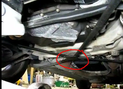

I struggled with this as well, here is the point I used for the front, the only "crossmember" I was able to find:

That plastic piece has a rubber insert when it is new. I'm not sure I'd want to jack from that point. I've used the same spot reko pointed out.

Sam has the correct front reinforced cross member for jack placement. Placing the jack under the aluminum cross member can lead to a shear/punching failure the will cost many $$$$$ to fix. The aluminum cross member system is really not designed to be jacked at any point. Even if the aluminum cross member does not fail completely it can develop a stress fracture that might lead to failure later.

I've always used reco19's point. That crossmember looks very substantial. Seems to be some differing opinions here. I hope we can come to a definative answer!

Originally Posted by reko19
Sam,
Did you sneak into my garage to take that pic when I wasn't looking? The manly junk in the background looks strangely familiar.
After reading your post I was thinking I've been doing it wrong all this time. I'm glad some others have backed me up. I was always afraid to put the pump under those black braces because they just looked too fragile.

Sam,
the pic is from your garage, actually from your video to be exact
looks like you are right, hopefully i did not do any harm using aluminum crossbeam, only did it once

Curiosity Question? Is the crossbrace as depicted in the Reco19 picture unique to convertible vs. a coupe to counter body twist of a convertible vs. a coupe? When looking at the parts listing in FAQ section, it refers to the crossbrace as a "convertible" crossbrace. I know manufacturers will reinforce the undercarriage of a convertible vs. a hardtop.
Also, I have read that to lift the total front end of the vehicle, one should lift under the crossmember (crossbeam - Jaguar nomenclature?) between the A-arms. I have been lifting at the Reco19 location and putting a block of wood between the crossbrace and crossbeam to avoid distorting the crossbrace.
