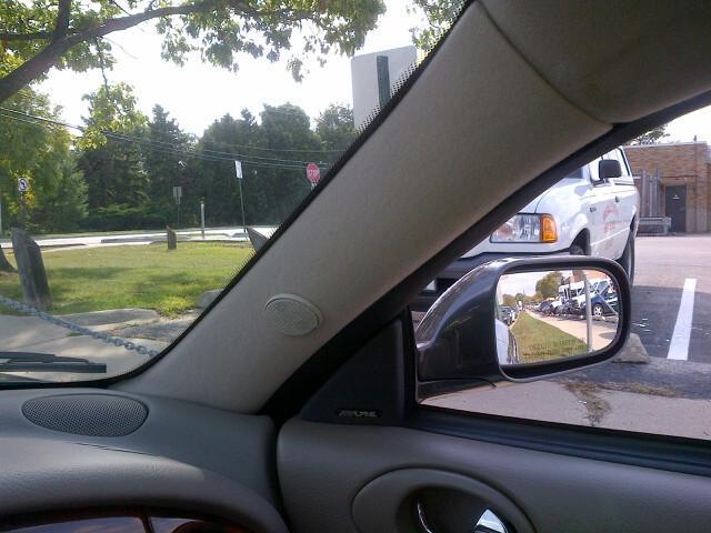

Default A Pillar remove, wash, and replace
Attached are my before and after pictures of my 2001 XK8 A-Pillars (like Great-Grandma's legs vs... well, someone much younger with nicer legs than Great-Grandma). My pillars were clean, just wrinkled. I took the material off, brushed the crumbling foam away from the cloth and the pillar (even a bit of sandpaper on blobs of foam near edges of pillar), then washed cloth in hot water and laundry soap by hand to get the foam crud off. Rinsed it very well. Glue wont stick to the surfactants in the soap! Laid the cloth out to dry overnight. . Did not replace the foam and used 3M headliner spray glue on both the fabric and the particle board and worked from the center out to edges. Super easy since everything was pre-cut. Still matched perfectly since mine were clean to start. I like the firmer backing on the pillars now- not a fan of that foam. I think it looks really good. If washing failed I knew what to do and where to get more material thanks to everyone here before me.
Only key for me was pulling "diagonal" by hand to get pillars out of their (3) clips. IE pull driver's side pillar from top of pillar toward passenger seat. Once clear of the clips gently pull it parallel to the door window so bottom part slips by dash. The bottom can hang up between dash and crack if you try to pull the whole piece out of there 'diagonally". Pretty rewarding for an hours work and $15 of glue!

Wow, looks great! I hope you like grandma's new suitors!
It was not practical for me though, because my fabric was beginning to rip in the corners.
