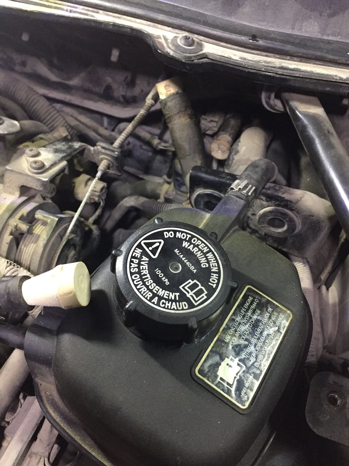

Been there done that. In the front engine fuse box compartment, there’s a relay which you jump.
The heater pump under the car should “whir” but the trouble is that it’s got a magnetic clutch which is known to fail. So pump motor spins but doesn’t pump. The way I checked this was to take one of the bulkhead hoses to the heater core off and physically checked I had flow.
Pic of location of bulkhead hose connectors for heater core. The other thing to note is that if you have no heat it’s often the water solenoid valve thingy.
Good luck
