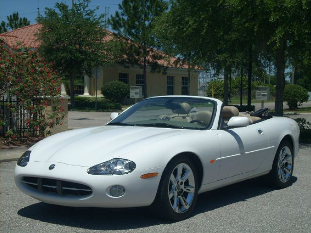

here is one pic. Still have to have it shipped to me.

Welcome Back brgjag
nice looking cat.

Welcome back! I forget--why did you sell your original one?
Anyway white was my first choice when I was first shopping around for these but they are not all that common.
