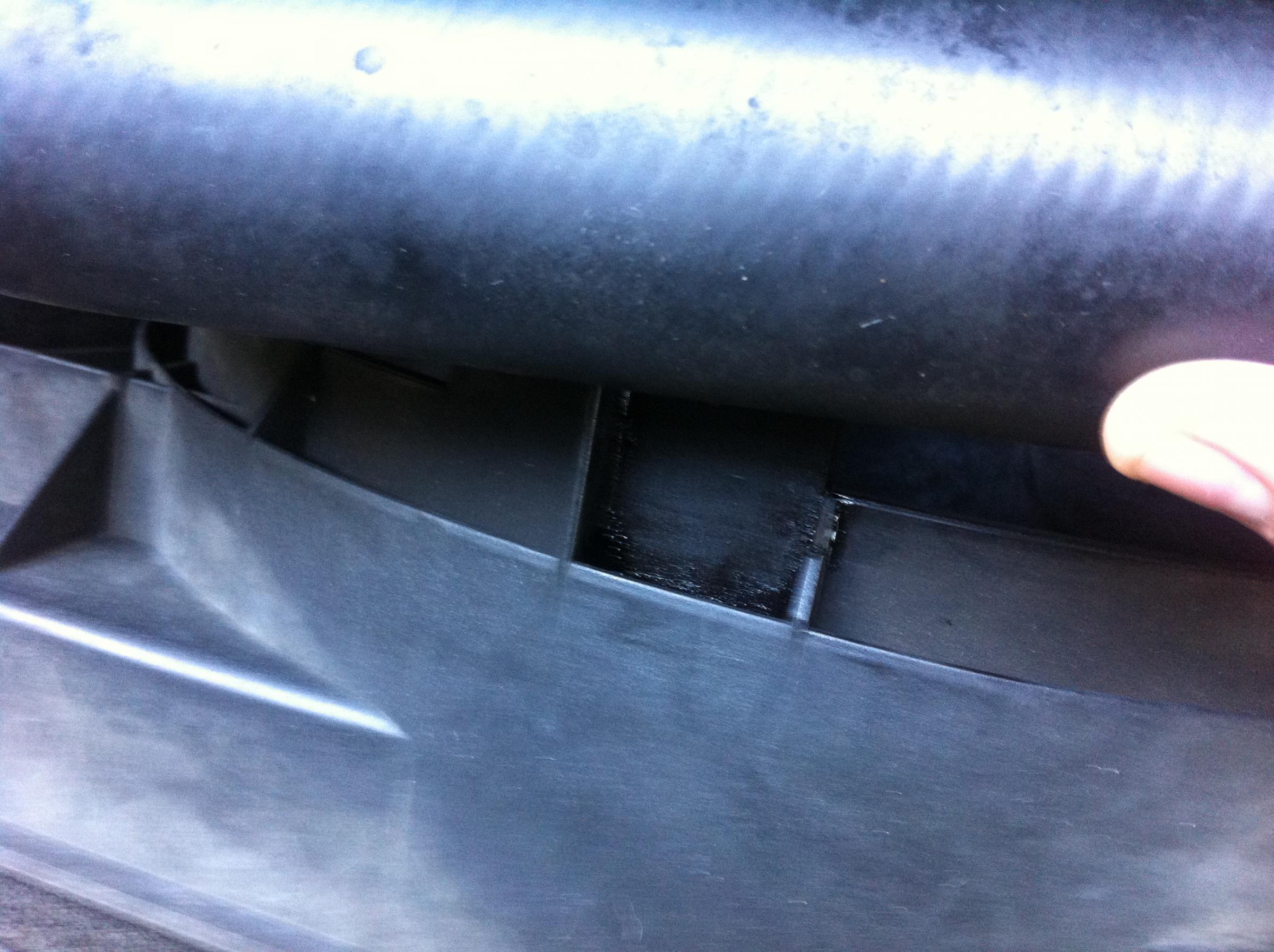

I've been driving the car worry free ever since I changed the timing chain tensioners. About a thousand miles ago I performed my last fix on the car, I changed a hose that connects the coolant reservoir to the thermostat housing. Then I topped off with some coolant and have been driving problem free. Today I decided to take a look at the engine bay, and check all fluid levels. When I checked the coolant reservoir it was half full. I was thinking, that's odd. That shouldn't be so low. It wasn't low enough to trigger the coolant low message. I topped it off and then inspected all hoses that were visible. They all seemed ok to me.
Then I took a look at the fans parallel to the radiator. That's when I noticed what seemed like some oil on one of the grooves above the fans. I proceeded to feel the nearest hose. Only to find what seemed like a melted and slit spot on the hose. It seems the grooves on the plastic above the fans come in contact with that hose.

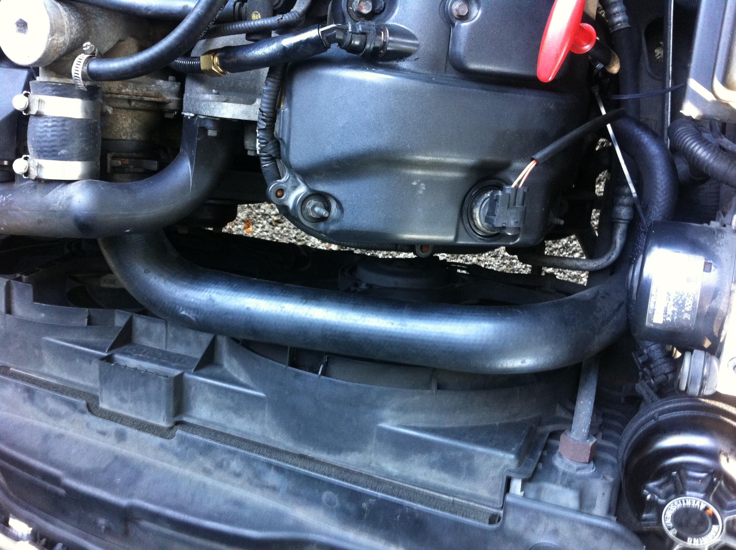

So now I'm wondering... My logic tells me that that's a coolant hose, I mean it clearly connects to the thermostat housing and the radiator. Why was the fluid leaking out more consistent with sludge than coolant fluid? When I topped off my coolant, I had not seen any foam on it, nor an orange color. It was green, just like the coolant I filled it with. My coolant cap had nothing on it either. Could that sludge be a result of the coolant oxidizing with the ambient oxygen? Could the high temperatures of the engine bay catalyze such an oxidation reaction?

I guess I have to buy a new hose and two new clamps. I'll have to modify the hose so that it has at least about two or three centimeters of gap between the plastic and it.
What diameter hose do I have to buy? How long does it have to be?

I just replaced both my radiator hoses, along with a new radiator. Got everything from RockAuto.
The hose will actually fit either direction; however, going on one way it clears everything pretty well. If put on the opposite way, it gets pretty close to things. It's hard to tell which direction is right, you just have to try both ways before you actually install.
My guess is that yours was replaced at some point and put on the "wrong" way.

Having read this post, I checked the hose on my car, and sure enough it is just about worn through at the same spot where it is making contact with the small fin on top of the radiator. A new hose is needed ASAP.
I would recommend to everyone that you check these hoses, as it is a disaster waiting to happen. I am fairly sure that this hose on my car is original.

Lower hose....it goes to the bottom radiator fitting driver's side, right? The upper is short over to the pass. side...(from memory, but I can check tomorrow).

I found the same problem on my XK8 last year after someone reported a leak. When I replaced the hose I not only trimmed the end, but also cut the fin back a little.

Yes, it's the hose that's on the driver's side which connects to the bottom of the radiator fitting. So, that's the lower hose? It is pretty much the same price with shipping. I'll check my local auto parts store first.
How do you suggest I catch the coolant? Should I jack up the car and put a bucket underneath while I work on it?

RE: Your radiator hose touching the edge of the fan shroud. Double check that it is not installed in the reverse. Mine was and I had the same chaffing. Once you pull it off it is apparent how it can be installed backwards very easily. gordo

Yeah Gordo, I'm starting to think that there is a high possibility that the hose may be on backwards, as you suggest. I don't recall any radiator or fan work. So, I guess I'll have to ask the previous owner about that.

Yeah, def lower hose then. We have a place nearby that sells disposable Al baking pans (turkeys, etc.) that fit under there and catch alot of it when that hose comes off the bottom of the radiator. Messy, but.........

Mine was still a very tight fit and was still not happy with the clearance between the hose and the shroud. I cut about a 2" piece of the old hose split it and secured it around the new hose at the friction point with a couple of wire ties. If your worried about showing your car clip the ties and remove the piece. Hope it helps Jim

Once you pull the hose, it will be obvious how easily one can install it backwards.
