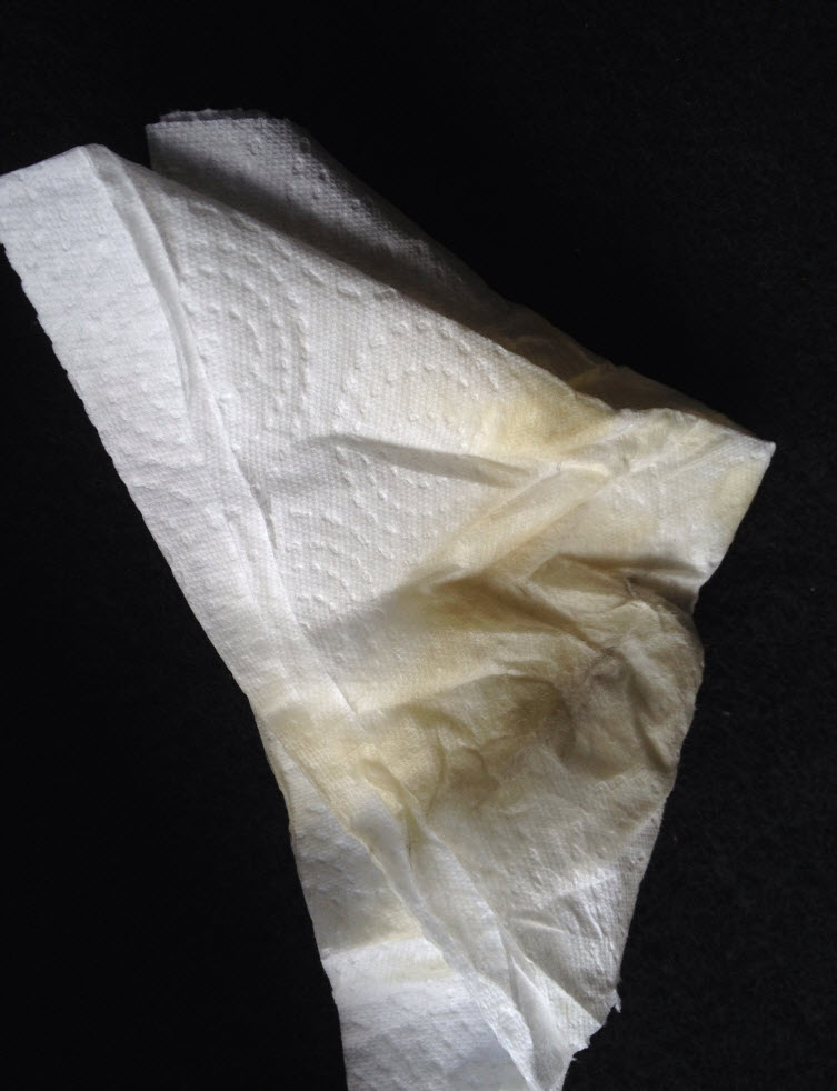

Old Jun 28, 2013 | 03:33 AM
azeteg's Avatar
Joined: May 2012
Posts: 289
Likes: 51
From: Liechtenstein
Originally Posted by Jag#4
+1 on checking the color. Find out what fluid you're dealing with.
Already did that - the color is yellow with a hint of brown, resembles the engine oil I have in her - Mobil1 ESP 5w30.
I could perhaps also suspect brake fluid, which would have about the same yellow color, but brake fluid should be less oily to the touch...
Old Jun 28, 2013 | 11:42 AM
Jag#4's Avatar
Joined: Feb 2012
Posts: 2,997
Likes: 714
From: Waco, Texas, US
Doesn't look like top hydraulic fluid to me. I think the really old stuff was yellow, but what you have looks more like used motor oil. Jon89's idea that it was traveling to the rear from a front leak has some real merit.
Someone more familiar will chime in soon I'm sure.
Old Jun 28, 2013 | 12:21 PM
azeteg's Avatar
Joined: May 2012
Posts: 289
Likes: 51
From: Liechtenstein
Travelling to the rear, teleporting itself under the battery.
Currently my theory is pretty simple. I used to have a half-full bottle of oil in the trunk for topping up. Perhaps it leaked without me noticing, with time (even after removing the bottle) trickling down to this position. The cover for the battery did have some oil on it, but it was actually more only on the bottom part of it.
I hope it is nothing more serious than this, because on sunday we leave for a 2 week road trip in Tuscany (Italy), for some winding roads between the wineries of the Chianti region.
