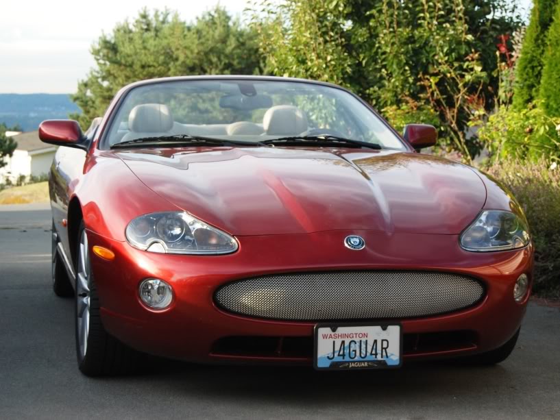

Hey Jaggyx - I just installed a Mina convex mesh grille on a 2006 about a month ago, and LOVE the look. The toughest part is getting the old "rabbit tooth" grille out. The horizontal piece is simple, but the vertical black plastic guys are tricky. There are lots of posts on the Forum about that. The hard part is trying to pry the "tree fittings" out. I finally just cut the heads off. You do not need to remove the bumper, but you need to twist it a bit to get those pieces out. I didn't trust the tiny Mina screws, so I got some larger ones. Mina instructions are poor at best, but again, there's a lot of guidance available here. Just search on "mesh grille".
Here's how mine looks:
All the best -

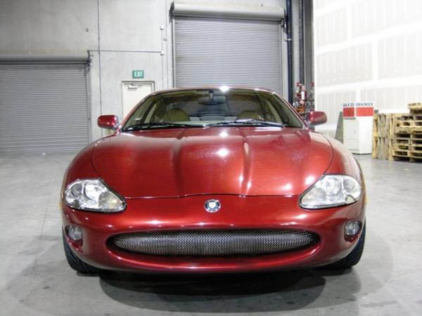

here's mine for a comparo in Carnival like Larry's!!
-Tony

looks nice, both of you!

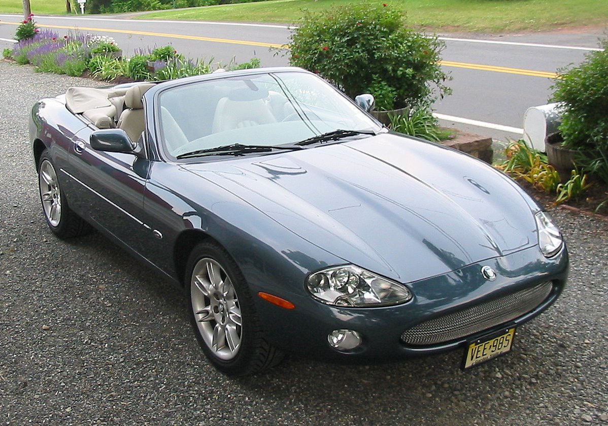

My grille (if a picture shows up; not exactly sure what I'm doing yet) is from Adamesh.co.uk. Some nice stuff on the shelf there.
