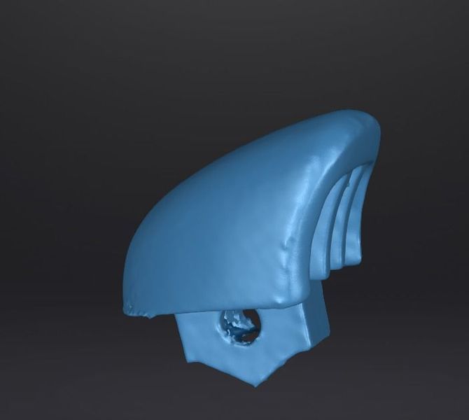

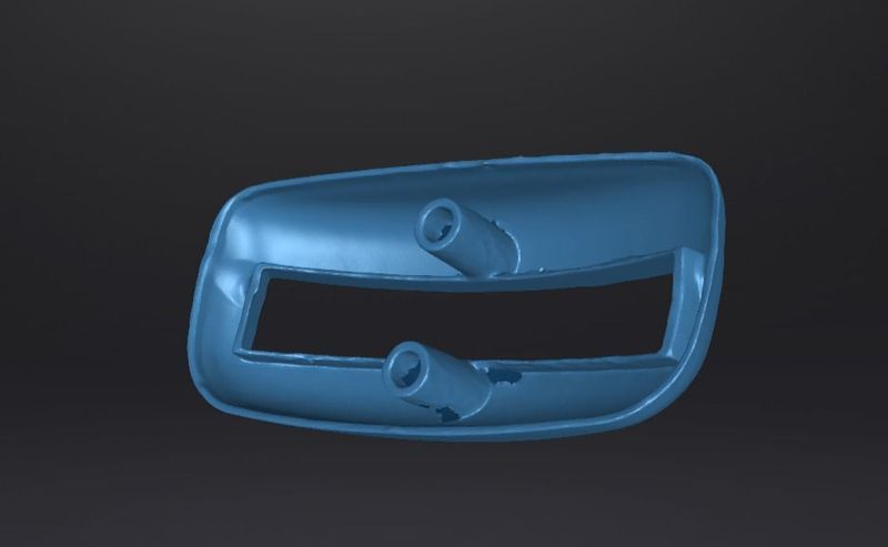

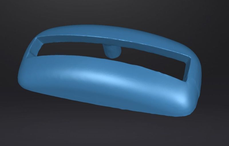

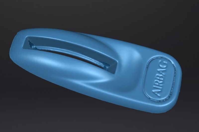

Update: I have started scanning them
Also, would there be any interest in the cabin filter bracket to be recreated?

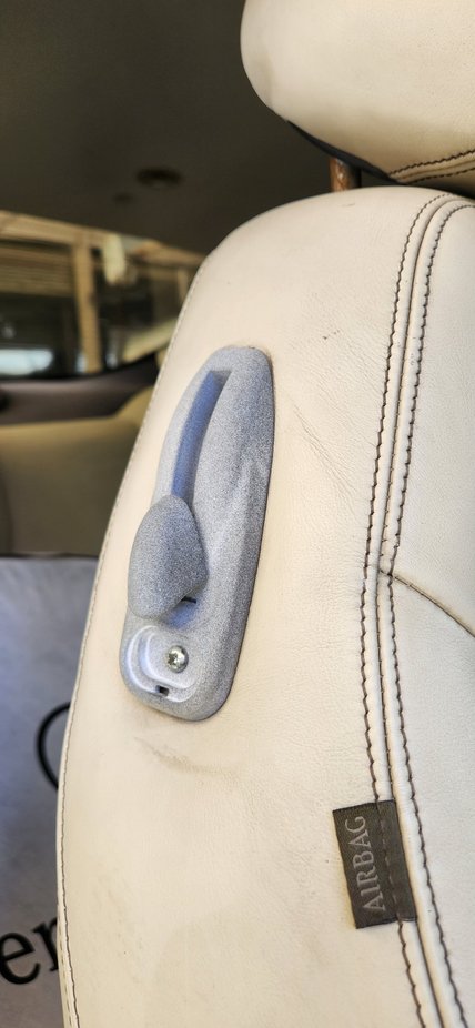

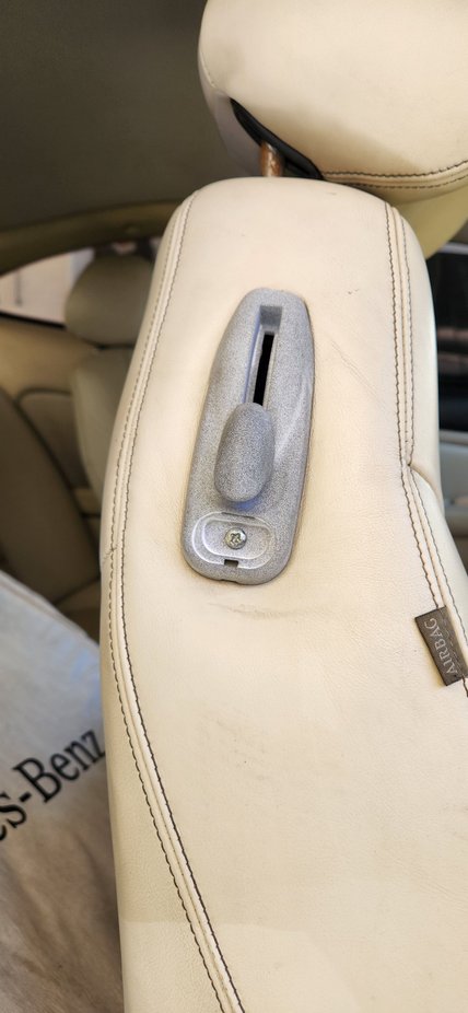

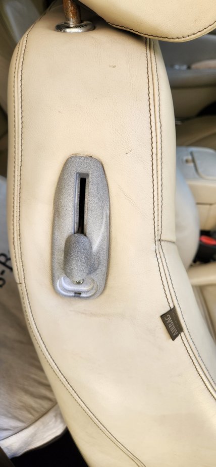

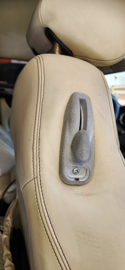

X100 gen 1 and gen 2 seat lever surround (escutcheon) are now available at MMG Engineering.
Manufactured using the latest in additive manufacturing/3D printing technology. Parts are printed in MFJ machines using PA12 material and in raw finish ready to receive primer and paint.
All our parts are printed using industrial grade materials using state of the art printers.
Production time can take from 10 to 14 days.
$25 Gen 1
$35 Gen 2
$15 Knob
Fedex priority shipping to your location
Payment by Paypal only
https://instagram.com/mmg_engineering
