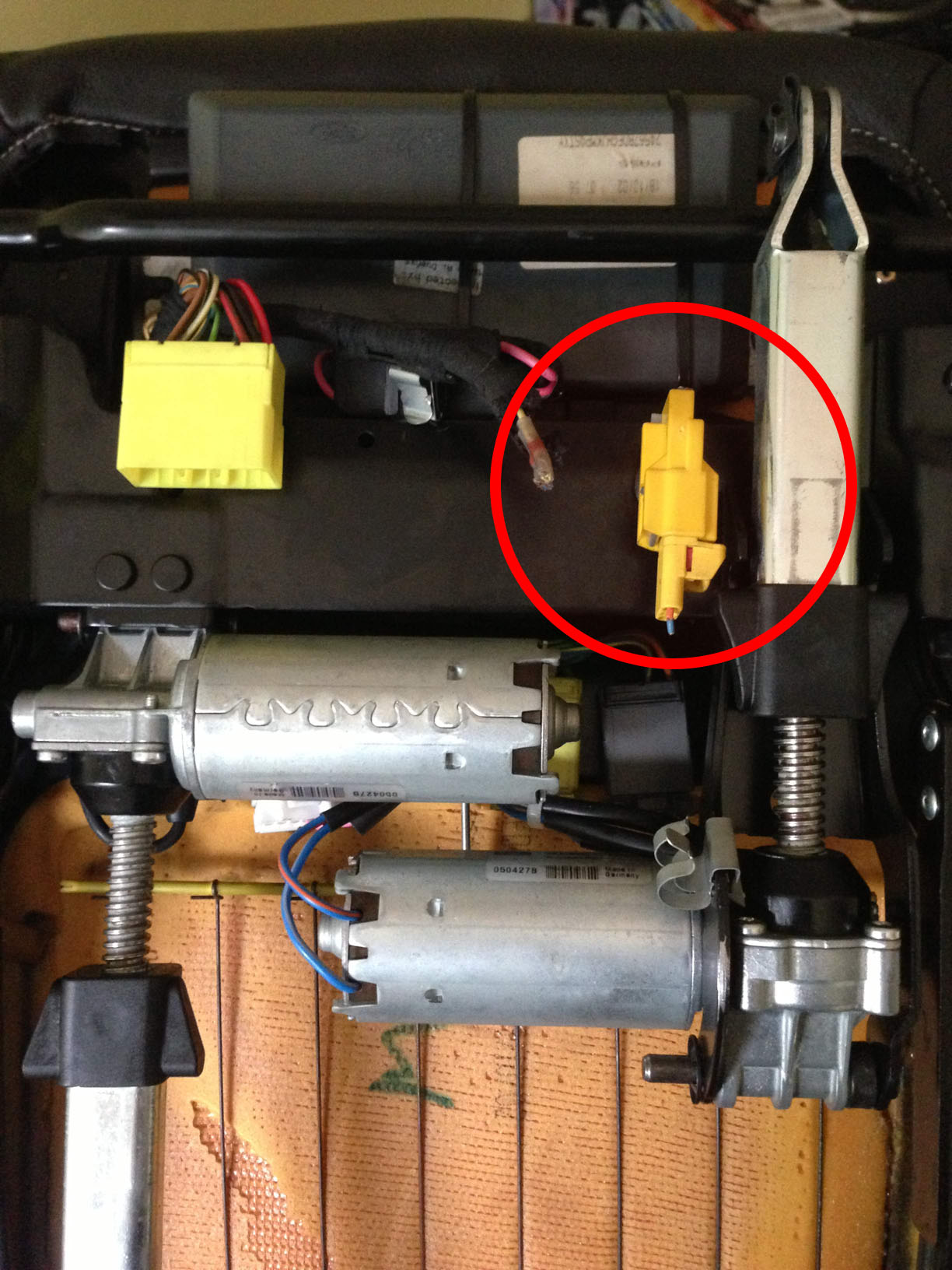

Hi Andy!
I suspect, you have the newer seat variant with the separate Headrest.
These are equipped with a side-airbag in the backrest. This is connected to the rest of the car by a two pin connector on seat's underside as you can see on the attached pic. Another similar connector is mounted at the airbag itself in the backrest, wich is much more of a challenge to get at.
Both are vulnerable to contact-failure prob's over the years, but if you get the errorcode when moving the seat, there's a good chance, that the shown connector ( or its cabling ) at the bottom is the cause.
The 'blink-code' you get with a failed connection to the side-airbag is 2-2. Maybe it could be sufficient to clean the contacts and bend them carefully a little bit.
And please: BE CAREFUL - as it was said before: DISCONNECT the Battery and WAIT at least 10 min. before you do anything with the Airbag-connectors. So best would be to unmount the seat bolts while moving the seat back and fore, disconnect battery, WAIT, get the seat out of the car and check the cabling and connectors, if you have the mentioned before 2-2 blink-code.
BTW: Be very careful with moving the seat out of the car, as the seat-rails are very sharp and can easily damage the rear quarter trim ( or your hands :-)
Good luck...
Wolf

Thanks for that Wolf, much appreciated and yes, you're right, the seats are the later type with the separate motor driven head rest.
The irony of the situation is that the light has gone out completely now. The previous owner was a really big fella and he had the seat all the way back and it was only when I adjusted it forward that the light started messing about.
The car is for my wife and we adjusted the seat for her yesterday, which is quite far forward, and the light hasn't been on since.
I suspect it will come back in due course, as these things rarely have a habit of repairing themselves, so I'll put it on my 'To do list'!
I'll let you know how it goes.
Andy
