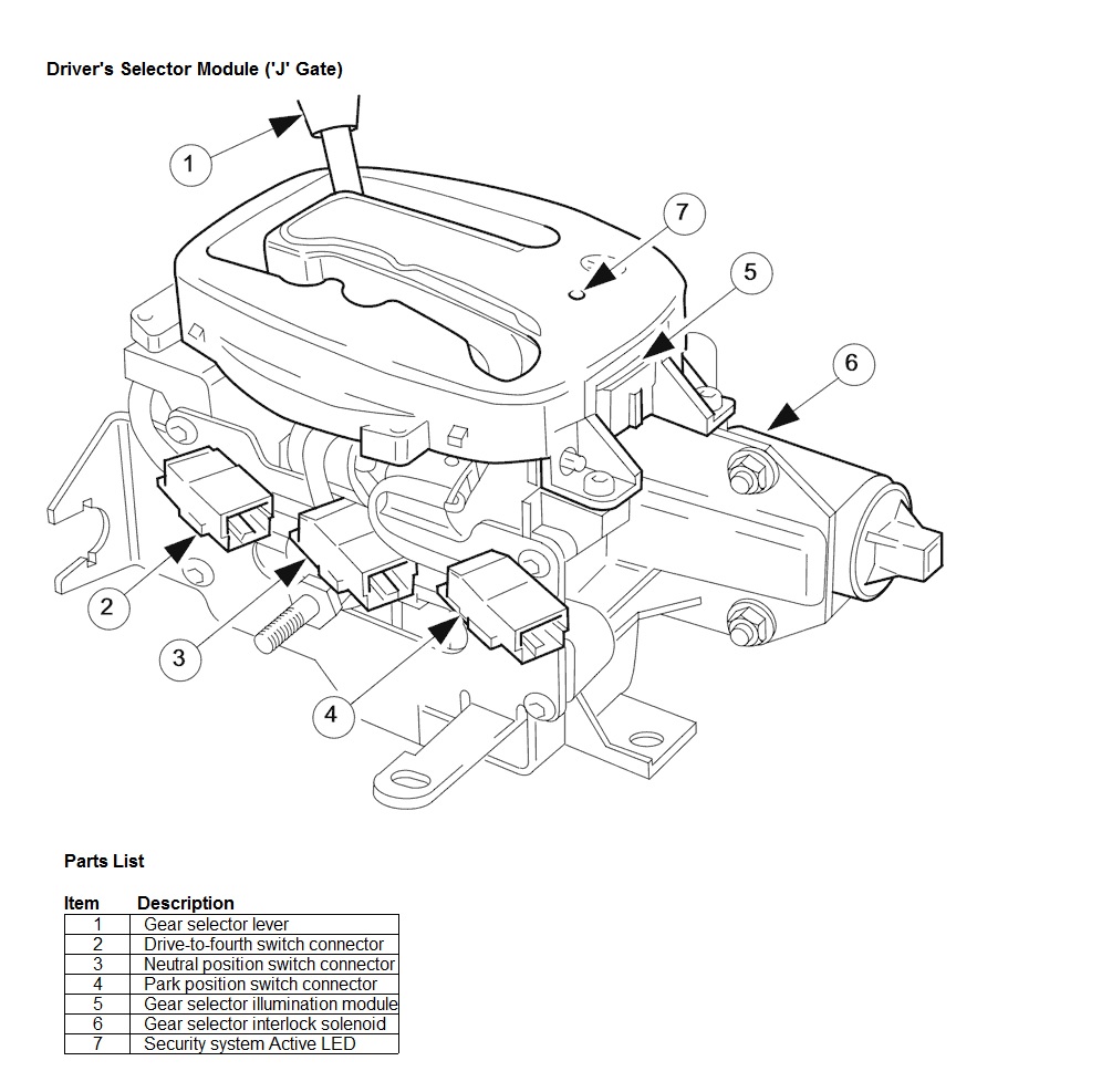

The usual J Gate/Selector lockup issues are with the Interlock Solenoid or the Rotary Switch on the side of the transmission.

What I jumped was the "Park Position" 2 wire connector, number 4 in the illustration.
I didn't leave the jumper (paper clip) in place, but reinstalled the small metal levers back on the switch after bending them back into shape. The "neutral position switch" metal lever was also bent and the little tab that keeps it from flipping too far out of position was broken off.
I was just wondering if I could make a permanent jumper, eliminating the "park Position" switch and future problems since I'm not sure what caused the metal levers to become bent and leave the car stranded.

Dave,
Both the Park and Neutral position switches are hard wired to the Body Processor Module.
Their function is to detect when the gear selector lever is moved to the Park or Neutral positions respectively. This is part of the safety interlock feature to ensure the vehicle cannot be started in anything but Park or Neutral.
You've shown that jumping the Park achieves the result of allowing the vehicle to be started but, once the gear selector is moved out of Park, it has to be continuously sending a false gear selector position signal to the BPM.
I have an uneasy feeling about this as anything other than an emergency get-you-home solution.
