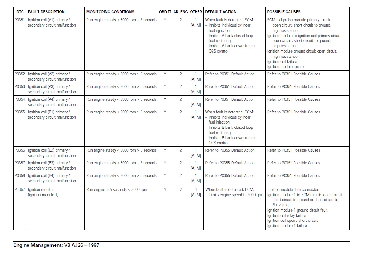

It's unlikely but not unknown for three coils to fail at the same time. From the coil numbers you've quoted, it appears you may be using a generic lookup. The Jaguar DTC listing for the faults you have is:

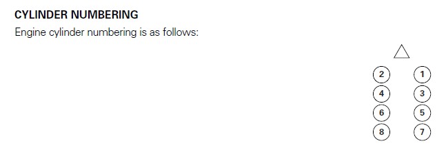

Cylinder numbering on the early V8 is:

Attached Thumbnails Jaguar xk8 computer problems, please help-dtc-1997-xk8.jpg

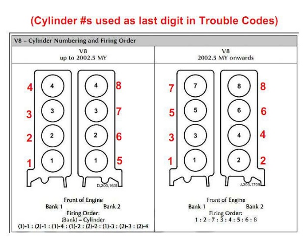

Crick in neck = I don't think that bank setup's right, Graham
From XK DTC
Attached Thumbnails Jaguar xk8 computer problems, please help-srs01-apr.-12.jpg
From XK DTC
That's right for 2002.5 MY onwards.
I only included the 1997 MY.
