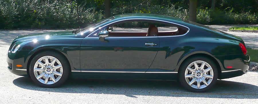

Gus: Thanks for asking.
Actually, I have been spending time driving my latest "Acquisition". The 2005 Bentley is a "Different Driving Experience".
But I still love my XKR!

Now you made me sick. WoW! what a car.

Looking good in all that hunter green my man.

Thanks. Actually both the XKR and the Bentley are British Racing Green (Non-Metalic). (Bentley calls it Barnato Green).

Is the ride as good as the car looks? You must love green!

It was one of the very few Continental GT colors that I found acceptable.
I have lusted after the GT since it was introduced, but could only afford one after 5 years of depreciation.
The Bentley has a few warts but is quite nice.
I wish there was a Forum as Good as This one, but for the GT. But the Bentley Continental GT Forum on Roadfly is little visited and mostly by jealous Trolls.
If I HAD to choose between the Bentley or the Jaguar, I would have the Jaguar!!!!!
