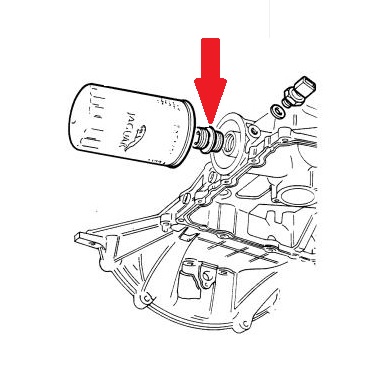

Two possibilities come to mind:
1. faulty oil filter thread
2. oil filter adaptor (arrowed in red) is loosened or threads damaged
Either way, the 'problem' filter has to come off.

I have a slight leak in the same area. I dismissed the oil filter as I have never had that problem. My guess was the leak was at either the oil pressure or oil temperature sensors, but they both seemed OK. For now I will live with the leak and the next oil change will check the oil pan adaptor and make sure it is not backing off.
