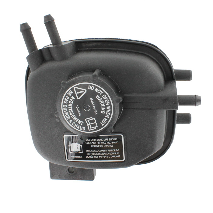

I have a leak or crack somewhere in the tank or hose connected to it, I can visibly see the drips underneath when it gets hot.
Can someone post how to remove for inspection?
I already added the stop leak which didn't make any difference.
If I find the crack can I use JB Water Weld to fix the crack, or would something else work better?

I've done this a few times.
1. Suck out all the coolant from the tank. Disconnect the coolant sensor pigtail.
2. Remove the hoses from the top of the tank.Pinch them off if they leak.
3. Remove the bolt. Its easier to get to the bottom hose.
4. Remove the bottom hose. Pinch it off or use a wine bottle cork to prevent spillage.
5. Its out!
I don't know if JB Weld will make a permanent fix. I often wonder if several coats of Flex Seal (As Seen on TV) would fix it.

It could also be a leaking cap...around 20 bucks to replace.
If it is the tank that is cracked also replace it. Don't bet your engine on some JB-Weld. It will fail again under the stress of temperature and pressure.

After two attempts with JB Weld I can attest to the fact that it will not be a permanent repair. Mine cracked away from the seam and I roughed up the plastic to the extent that it had both a rough surface and 'feathers' for the epoxy to attach to. Lasted a few months.

Agreed. Sooner or later they all fail. The only sure bet is a new tank....

+1 on the new tank. Verify it is not a hose or the sensor on the bottom that is leaking first.
A new tank will come with a new sensor and a new cap. Cheap insurance for your engine.

If it keeps leaking out the bottom, not from the cap, and it shows low coolant, is that low enough to remove hoses and take off to inspect, or do I have to suck out more of the coolant?

NO - the outlet is at the bottom so you either need to suck the tank almost empty or lose the coolant in the tank when you disconnect the hose.

I had good luck on another application with WaterWeld which is a JB Weld product for water-use solutions. You will need to drain the tank so the epoxy can dry correctly.
Despite the fact it might hold long-term, I would not use this as a permanent fix. You will just be doing it again on another spot eventually...most likely at the worst possible moment. Once the plastic in those tanks start going, they never get better.

You will need a T27 for the expansion tank. Follow the instructions from mromanik at the top. I also added a towel under the tank to catch coolant, and I replaced the clamps at the same time. Just squeeze the outside "humps" with the pliers towards each other.
Once you are done, start the car and let it warm up to esnure no further leaks. I had to adjust the screw type clamps afterwards, since it was still leaking coolant.

A new tank.
You do understand that a sudden evacuation of the cooling system may overheat the engine to the extent that it will need to be replaced?

I fixed a leak on the radiator tanks with this stuff. It will easily hold on the expansion tank if applied correctly.
But as mentioned before, use it only until you replace the tank. Not that it won't be permanent, but that the tank will simply start to leak somewhere else.
