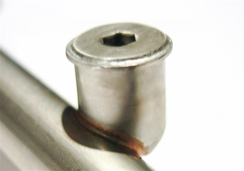

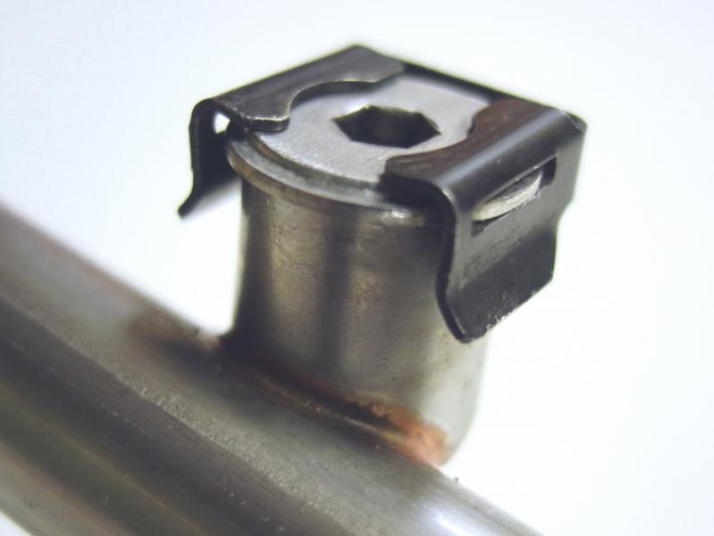

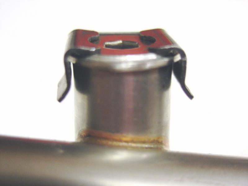

This morning, as I was driving to work, I began thinking that even though silver solder is very strong, I would have real problems if, for some reason, the solder suddenly failed and the bolt blew out of the rail dumping a stream of 70 psi fuel directly onto a very hot cylinder head and splattering all over the engine compartment! Ummmm, yeah... Probably not very pleasant results huh?
Tonight when I got brave and blocked off the first of two damper "cups" on the actual fuel rail that will go back on my car, I got to thinking again about devising a "keeper" to add a solid mechanical "safety-stop" to the capped off damper cup. Steve was undoubtedly correct when he surmised my dentist waiting room sketch would not work very well because it didn't apply even pressure. As I pondered a new design for a "clip type" of keeper, I looked at the pile of old Ebay injectors and clips from my research rail still setting on my workbench and BOOM! it hit me. I have what I needed right in front of me!!!
All I needed to do is get a ball-peen hammer and a punch then bend the spring steel "tangs" that used to slide into the side of an injector down just a little bit to apply pressure against the soldered "cap" when the clip was in position - and I had my solution...
There's NO way that bolt's blowing out now! AND the solder is solidly backed up with proven mechanical advantage!
How 'bout that guys?
Now all I have to do is solder up the other rail's damper cup, modify another clip and it's "reassembly time!"

... umm all very neat but ...
A mechanical backup isn't going to help you if a small gap develops.
How about just pinching the cup shut and silver soldering the seam?
Or cutting the cup off and patching the hole? If you have some slightly larger tubing than the rail and cut say 1/4 of it away, then it acts like a very wide circlip. Rotate the patch pipe/circlip over the hole and silver solder. Then the "circlip" is your mechanical strength and the silver solder is the sealant.
Then again, you could just cut the fuel rail slide the cut pieces into a proper sized pipe and have the whole works tig welded back together. Of course you have to jig it up properly to maintain alignment.

Maxwdg, like Plums I don't like your solution, beautifully crafted as it is. You've got a line contact between your bolt head and the tube. Think about a plumbing fitting where the pipe fits some way into the joint socket and the whole mating surface is filled with solder. What you want is a brass plug extending into the socket and silver soldered in place. It would take 5 minutes to make on a lathe - I'd make you a set but I'm not going to be around much for the next few weeks.

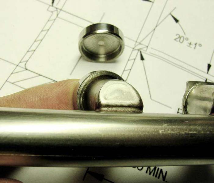

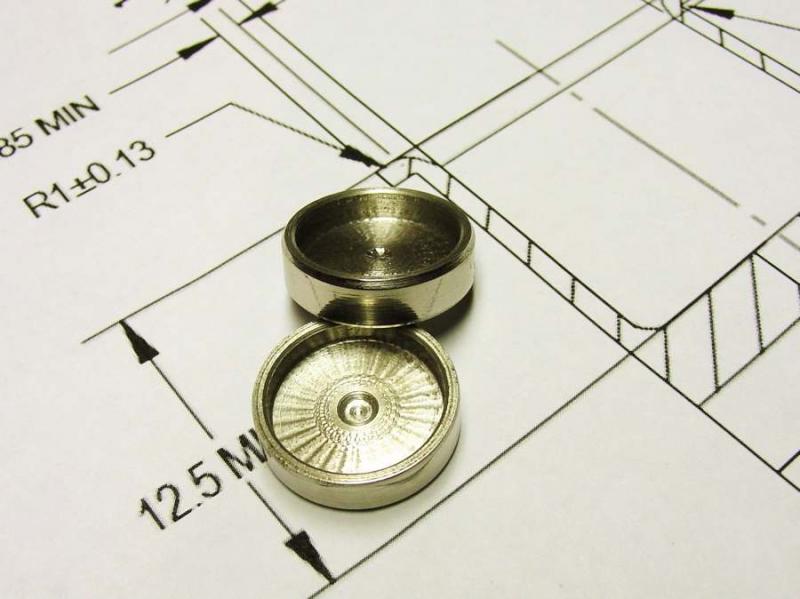

Custom Machined Caps!
Received a little package from Oklahoma City yesterday - Guess what? It contained a couple of stainless steel caps that just happened to be exactly the right size to put a stopper on two fuel pulsation damper cups...
See the pics for the result: Pressure testing tomorrow night.

Hmmm ... nice fit ... I'd almost think they were custom made
