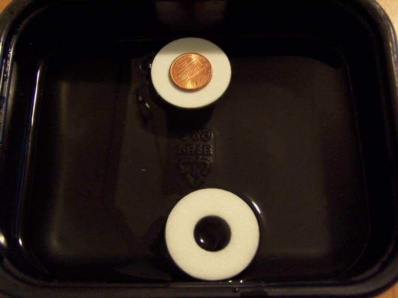

Another float option I am using is the foam rings I found on a spindle of blank DVDs. I have a couple submerged in antifreeze to see if the deteriorate. As you can see it will float with a penny on it. I guessed that the magnetic float would not weigh more. So far no low coolant message.
I took the tank off to do this. Don't know how you did it Spurlee with the tank still in the car.

Great job guys. I'm going to check my DVDs. Now if I can just get that darn magnet back in the OEM float and add that little life ring underneath I'l be in business. Romanik, please keep me informed if it does not stand up to the coolant. I think the life ring underneath will keep the magnet from falling out again.

So far the foam rings are not deteriorating submerged in the antifreeze and they still will float.
