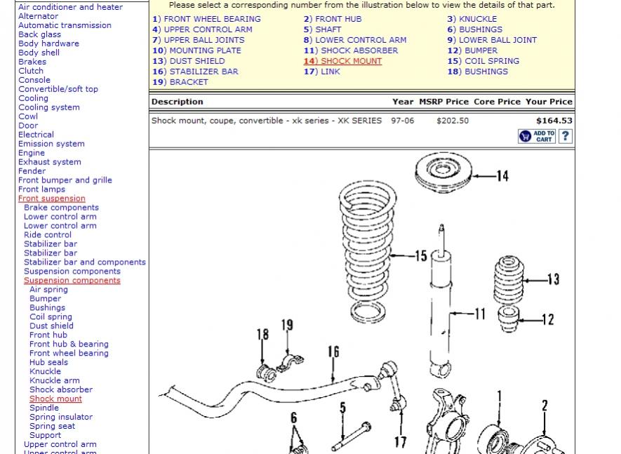

Here's MotorCars Ltd's own version of the upper shock mounts for our XK8s, if you can't find the jags...plus, its custom, so it might last longer?
Here's the OEM part and price from Jpamporschejaguarparts.com
Awhile back, when doing mine, the upper mounts were rare and nationally backordered.
