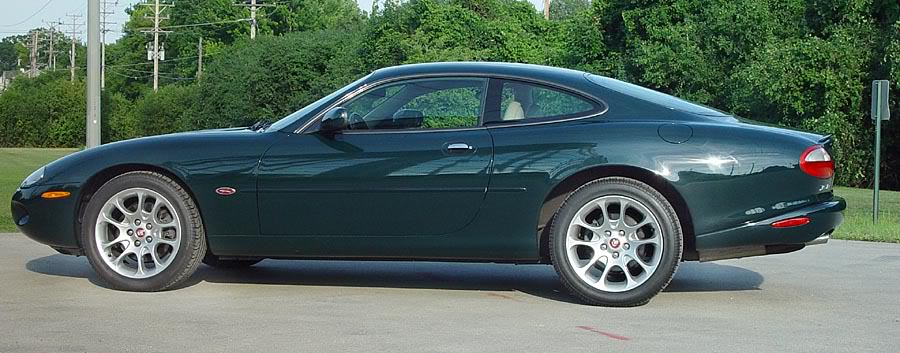

I too am going to be replacing the REAR ONLY Springs on my car with Mina Springs. I would urge anybody who wants to know what a "proper" rear stance is. to look at your (BeO's) album. Your car has a perfect clearance in the rear wheel well.
BeO: I hope you don't mind that I am showing this pic from your album:
I'm compelled to think that the springs on your car are for the European Market. U.S. Cars seem to have "Clearance for Tire Chains" built into them!
I also would not replace the Shocks. Unless there is deterioration in the bushings, the CATS shocks should be kept. Or replace the Bushings only.

My 2005 (= 2006 US, same as OP) looks like the photo above anyway. I don't really see why anyone would want lower still.

European cars sold in the States often get higher ride height and softer suspension settings to accommodate American preferences.

With some justification. There are lots of roads in the U.S. that are in poor repair and may benefit from a softer ride.

@Paul
Is the green XKR on the photo lowered?
Did you use wheel spacers and if yes which thickness?
I've got the double five rims as well but on my XKR the gap looks a lot bigger.

I don't use wheel spacers. I have just ordered the Rear Lowering Springs. The angle of the pic really doesn't show how large the gap is. With the rear lowered 1.2", the gap between the wheel and the body will be exactly the same as at the front. This is a better Picture:
