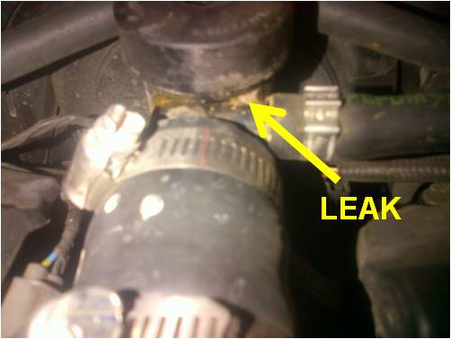

Default Thermostat Housing Photos
I have attached a wide-angle and close-up photo of my cheapass plastic thermostat housing in my '01 Vanden Plas.
Hope this helps.
Off to order a replacement.
Where could I find instructions for replacement of the housing?
I have a recently replaced thermostat.
Probably the reason that I need a new housing -- lousy mechanic.
(Click on pics to ENLARGE)
Attached Thumbnails Metal thermostat housing v Plastic housing-thermostat-housing-wide-s-.jpg   Metal thermostat housing v Plastic housing-thermostat-housing-closeup-s-.jpg

Old Sep 30, 2011 | 01:55 PM
Gus's Avatar
Gus
Joined: Jul 2008
Posts: 11,356
Likes: 2,236
From: Berlin Md.
This link should help Jaguar thermostat housing 4.0 xk8
