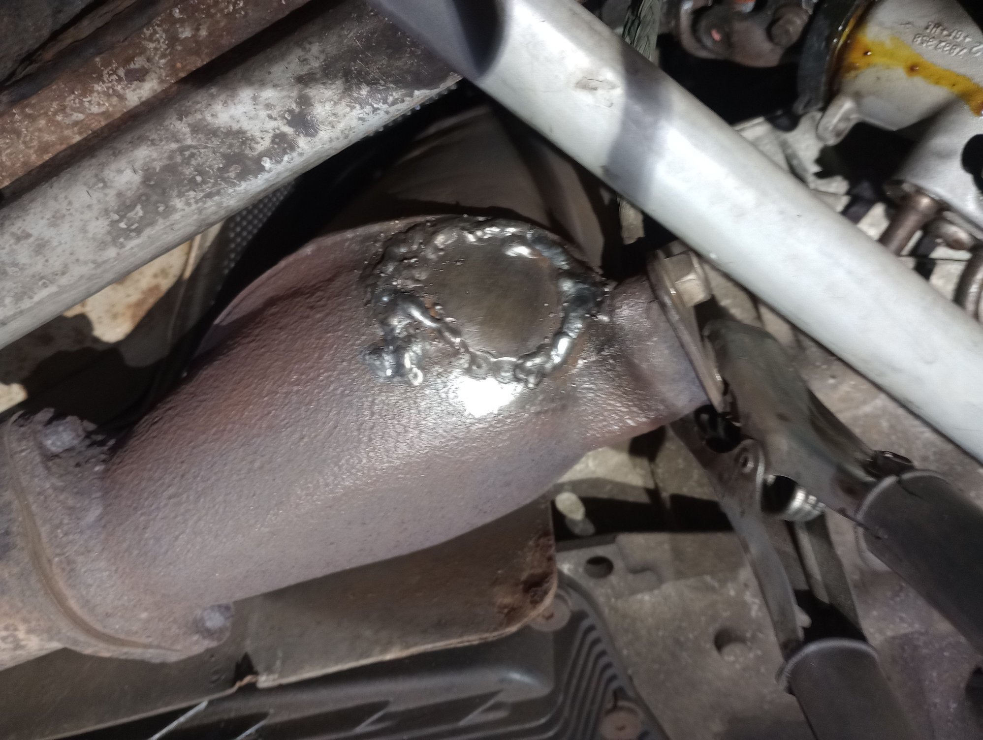

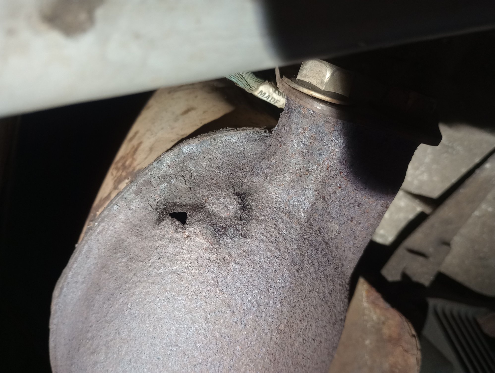

It's got a pin hole, so I got under the car for a look today. Looks a bit worse than a pin hole. Now this is already a second hand replacement. I will weld on a plate for the time being but was wondering if there is a UK compliant aftermarket one available yet?
Had a look at the other side,and it does have a pin hole too, moisture showing through. I have a replacement second hand one on the shelf for this side but would prefer new if available.

Doing well thanks, lots of trouble free motoring in the XK8.
That will do for the time being.

I do if I remember but didn't bother in this case as the welder earth was on the cat itself.
