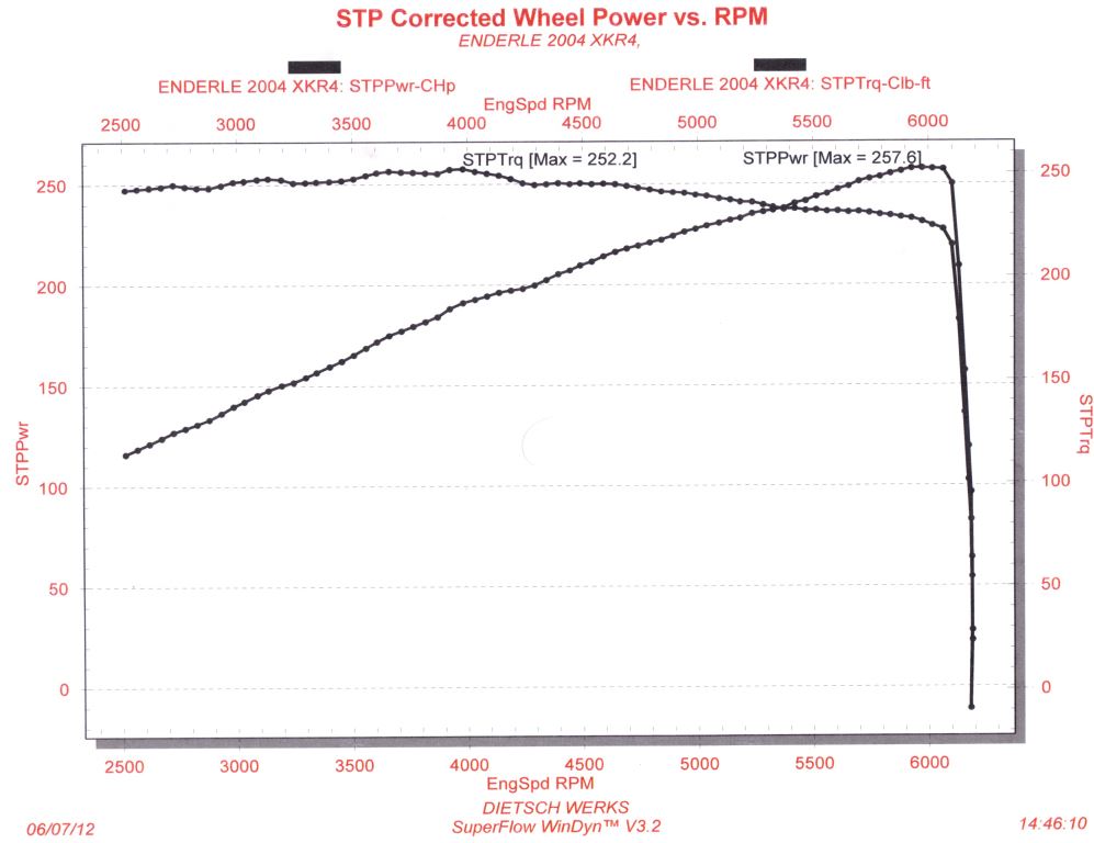

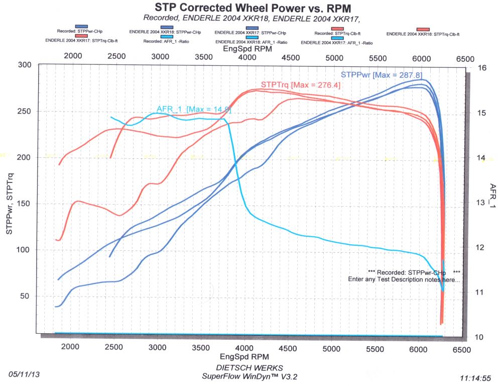

Here are the dyno charts, I rant full analysis the second time in prep for an ECU tune. Once again Superflows run really low so are best for just checking out deltas.
The first two show the runs on the Superflow, the last chart is an old Dynapack done around the time of the first Superflow just to show how low the Superflow is. HP is rear wheel.
I did add two resonators when I put on the Nameless cats (and these are cats not downpipes). I'd been running an x-pipe and just tail mufflers and the Nameless downpipes were so much louder that couldn't really drive the car so had to tone them down a bit. It is amazing how much loader the car gets when you put the cats on. I'd put in exhaust cutouts for fun when I pulled the resonators but with the Nameless cats the car was louder with the cutouts closed than the car had been with the stock cats and the cutouts open. And with the nameless cats and the cutouts open you'd wake the dead in the next county so they had to go. All of that happened between runs though.
Had a boost gauge installed in the meantime, boost was 12lbs at peak latest run.
Here are the pictures:
Attached Thumbnails Namless Cats Dyno Results-superflow-62012-small.jpg   Namless Cats Dyno Results-superflow-52013-small.jpg   Namless Cats Dyno Results-dynapack2.jpg

How many miles were on the stock cats? They might have been clogged.
I gained less than 10 hp according to the dyno with Nameless cat-less downpipes. About 15 hp according to 1/4 mile testing.

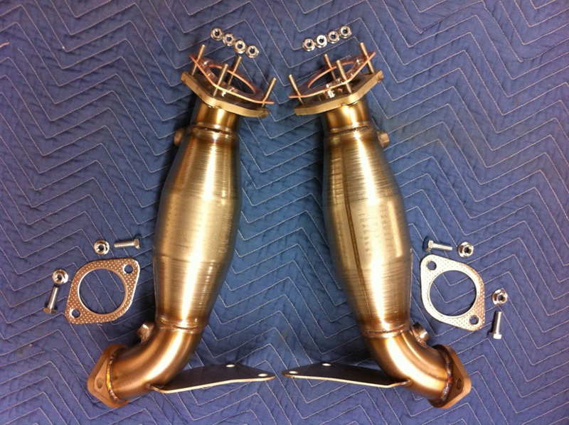

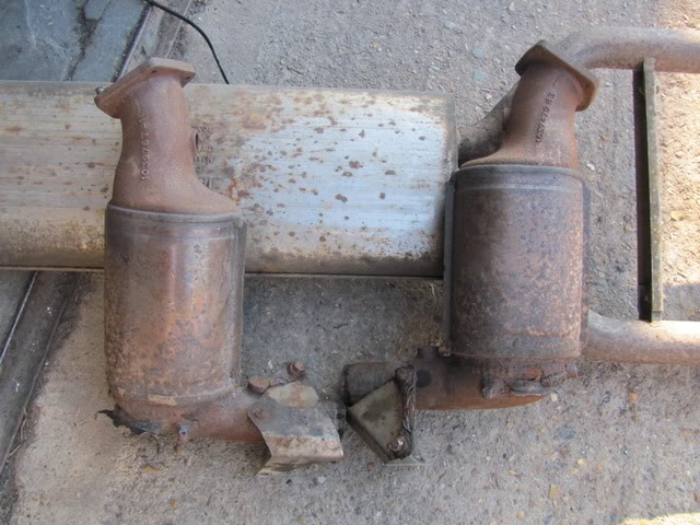

Originally Posted by SeismicGuy
So Bob--what's the bottom line here? I want to make sure I understand the terminology. I thought the stock "downpipes" had integrated cats--am I wrong.
These are the factory cats:
Originally Posted by XKRacer
These are the NP cats:
Perhaps you can understand why I think you're crazy if you think they only add sound. :P
Attached Thumbnails Namless Cats Dyno Results-img_0860.jpg   Namless Cats Dyno Results-jaguarxkr1g936971315439.jpg   Namless Cats Dyno Results-jaguarxkr1g936971315439.jpg

The most aggressive improvement I ever heard over at the Corvette Forum from doing exhaust mod was about 25-35HP and that was from installing long tube custom headers. Even Nameless Performance were not touting 30HP increases (thought it was more like 11hp) and the manufacturers pretty much always overstate performance gains. Which is why the 30HP increase just from swapping the stock cats for the NP cats seems astounding to say the least. Still if that's what was measured I guess that's what it is.

I agree the original cats may have been partially blocked as that would explain the increase.

I'd already changed out the exhaust so think that when I put on the new cats I finally got the benefit from the other changes (I was getting nothing from the other changes until I changed the cats). I can't explain it any other way though. I posted the charts.

Here is another thread with a larger exhaust, where just downpipes (without cats where installed). That yielded about 10-12 rwhp.
https://www.jaguarforums.com/forum/x...es-dyno-41275/
Most other dynos I've seen on our cars with sport cats where about the same. also on my car the sport cats would only have yielded 10 to 15 rwhp or so.
I would also guess that there where other things at play that gave you such a big difference, like jgaxkr suggested or something else, who knows.
