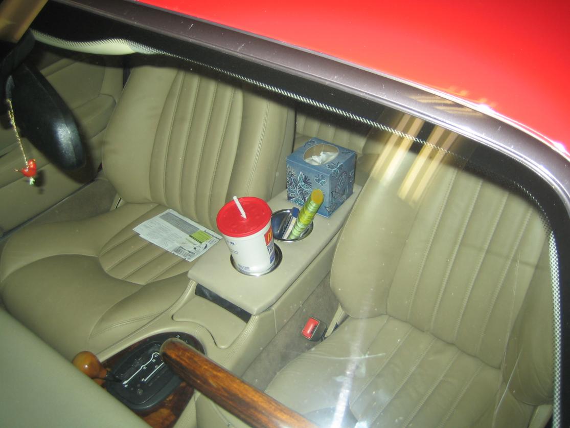

I just pulled the whole darn console cover including the cup holders out.
Then I made an insert covered it with matching leather and put two stainless steel cup holder in it. Added a tail on the rear to hold tissues. You know the big honken square kleenex box. (Its the Ohio valley, you try living here without them).
These work the factory ones work when you aren't moving! The console usually was just full of garbage anyway.
I got the stainless ones from a yacht sales and service center. I'm sure any boat store would have them also.
I wasn't worried about keeping this totally original. But I still have everything that I have taken off the car just in case. In case of what I don't know.

I'll post this evening. Everytime I look at it I want to do a little better job. I did this in about 4 hours.

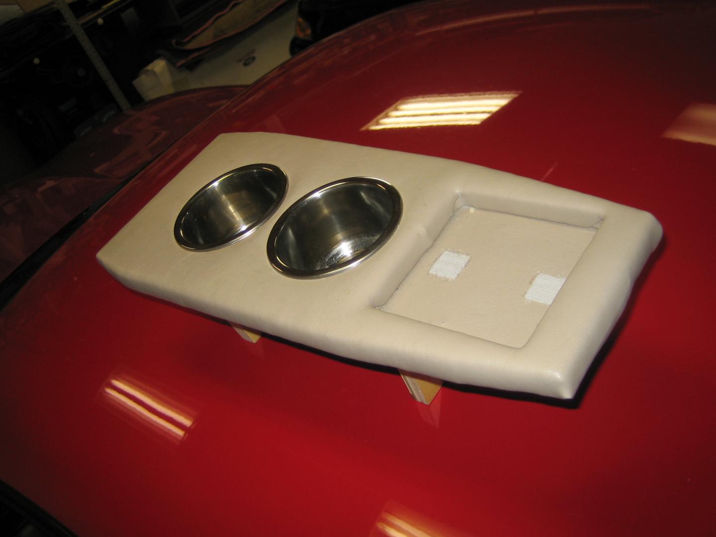

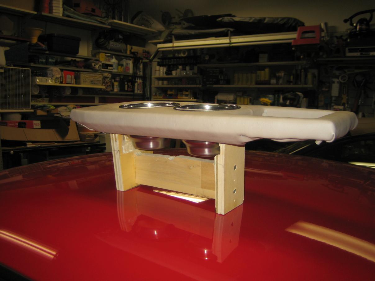

Like I said I did this very quickly. Basically I used 3/4" poplar plywood and cut it to fit within the slots in the storage bin. this is what holds it in place.
Then I made a shape that I was happy with, (at the time), and attached it to the pieces already cut to fit the slots in the bin. Then I wrapped the top shape with some polyfil for cushioning then covered it with the scrape leather I found at a leather shop.
Looking at it now it looks very crude but it works. The ultimate would be to cut a better shape and wrap it in walnut veneer and then but a lot of lacquar on it.
But it does hold a big gulp or a large mickey d's ice tea.
