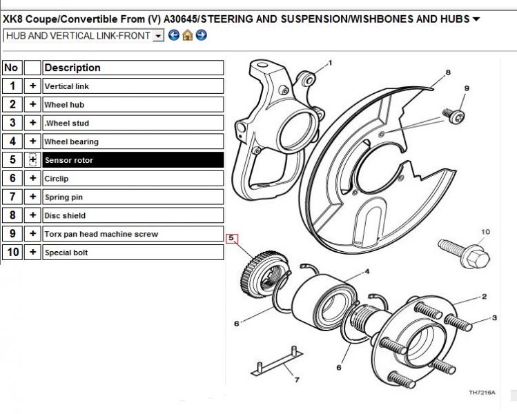

When cleaning the Sensors, it's worth checking the Sensor Rotors are clean and intact (item 5 in the 'Front' diagram and item 12 in the 'Rear' diagram):
New ABS/DSC Warnings and Experiences....-rotor-sensor-front.jpg
New ABS/DSC Warnings and Experiences....-rotor-sensor-rear.jpg
It's the gap in these toothed rings creates the signal.

Thanks, Graham. I'll attempt to get a good look at the sensor rotors this weekend....
