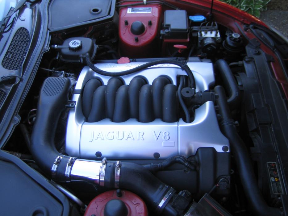

The new inlet pipe is 66 from the dealer. I fixed mine for about $12.00.
Just a 6"to 8" length of plastic pipe from pep boys. it came with the silicone sleeves but I had to buy 4 breeze clamps to install. Just cut out the corrugated part. the silicone connections will give enought movement in the snorkel to allow it to still flex under acceleration.
