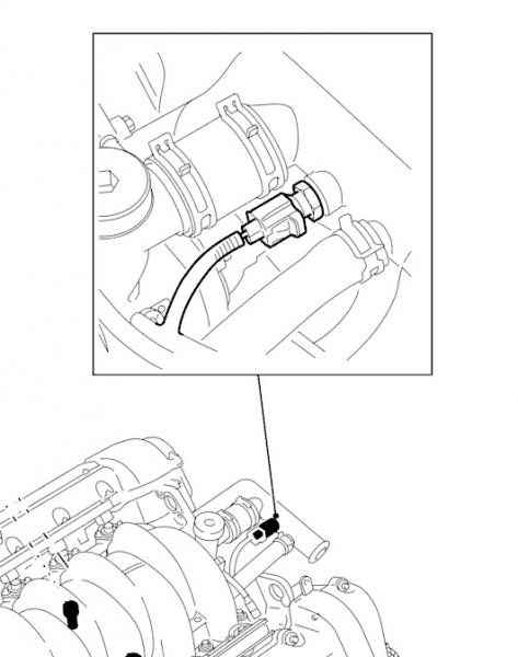

Here's the location of the Engine Coolant Temperature sensor:
Not got a reputation for failing.
Right, I don't remember ever seeing a report of a bad Coolant Temp Sensor.
Also, checking the (MY 2000) DTC list, there is no Trouble Code assigned specifically to a Coolant Temp Sensor malfunction.

Just started the Jag with the engine cold from overnight (35 degrees F) . It was warm to the touch within minutes and the engine hot within 4 minutes. The hoses leading to the radiator were warm within 5 minutes. The temp. gauge never went to the mid mark , even after driving for 10 min. the engine and radiator were hot as well as the heat in the car.
The sensor was located (many thanks to the diagrams supplied) and connection pulled and cleaned and reinstalled.
