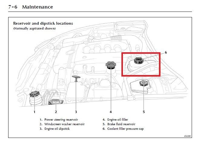

--How do I check the coolant level and where should the level be?

First determine whether the vehicle is actually losing coolant by checking the Expansion Tank level with a cold engine. It should be up to the base of the filler neck.
The usual cause of the light coming on intermittently is a faulty level sensor.
