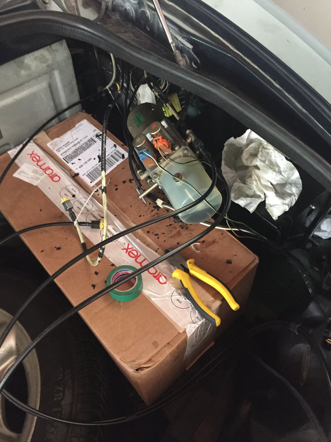

Default Here’s an old pic
Steve,
Here’s a couple of pics of what you’re dealing with. Getting a look at the pump and it’s hoses is a 2 min job. Open trunk, remove RHS wall carpet and pump is on top of the rack.
Here’s a pic of my previous work in progress with the pump moved off the rack. You can see the old bad hoses as the rubber sheath has disintegrated.
Easy for a quick peek to check.

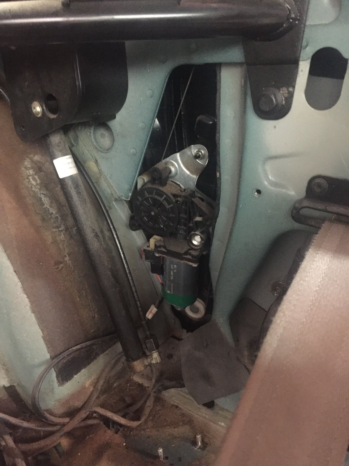

If you’re doing the overhead latch, then it’s worth checking the hydraulic rams behind the rear cabin quarter panels.
if you’re handy with a “wrench” it’s a relatively simple job to strip the rear interior to have a look.
if you have a leaking hydraulic ram, you’ll see the oil stain under the rear seats first.
