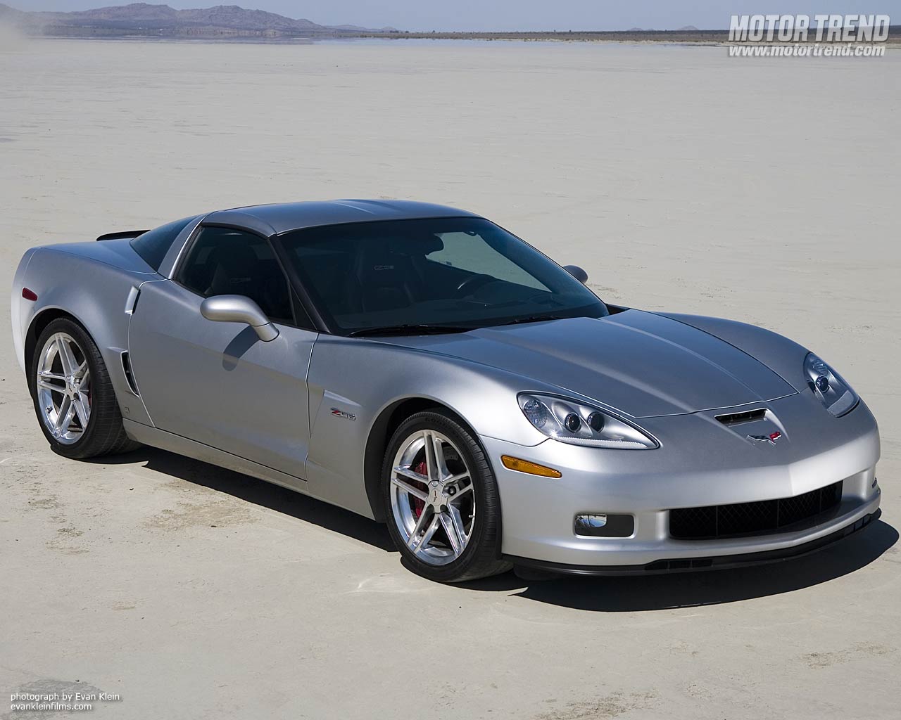

Why not get a Vette that already has an LS7/427 in it? I have a '07 Z06 like the one pictured here and love it. Yeah, I know, the Jag is a prettier car and has a nicer interior. But performance-wise, the Z06 with 505 hp in a car weighing approx 3130 lbs is far better than in an XK8 weighing approx 3900 to 4000 lbs. YMMV.

Nicer car, better interior, and also unique combination of power and style.
With all due respect, Corvettes are everywhere, but this is something very different....
(Aren't all Z06's hardtops as well??)

Corvettes aren't exactly everywhere, Toyotas and F-150s are everywhere, but Vettes are a lot more common than the Jags.
BTW, the LSx engines are everywhere so why put an everywhere-engine in a luxurious, sophisticated Jag? The engine is made by lowly Chebby, cam-in-block, 2 valve engine dating back to prehistoric times ... (I'll answer that question: because the LSx engines are lightweight, compact powerhouses + they're reliable as gravity and reasonably priced.)
(I'm just having fun here ... tongue in cheek ... I like my Z06 Vette and my 2 Jags.)
Yes, all Z06s are hardtops and for good reasons.
I agree w a poster that most Vettes (except the automatic convertible perhaps) and Jag XKs are in two different leagues. Now that Jag has the F-Type, a true sports car, I've read that Jag will probably move the next generation XK more into the GT arena.
