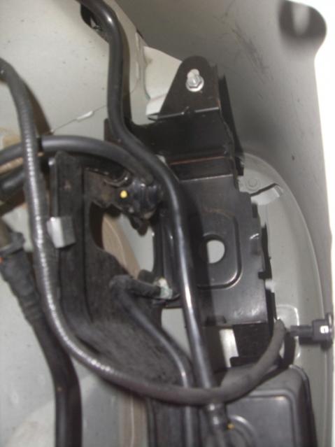

Does anyone know the location of the purge valve on the car? I have purchased a new one and want to replace it without tearing the car apart to find its location.
Old 01-12-2010, 08:01 AM
test point's Avatar
Join Date: Mar 2008
Location: Ellijay
Posts: 5,385
Received 1,110 Likes on 932 Posts
Front left hand wheel behind splash shield.
Remove wheel.
Remove splash shield
Remove wheel.
Here's a pic behind the splash shield on the drivers side wheelwell.
Other than the fuel odor, did you have any other symptoms? Did the check engine light come on?
Attached Thumbnails newbe XK8 owner - purge valve issue-driversidewheelwellhousing-002.jpg   newbe XK8 owner - purge valve issue-purgevalve-002.jpg
