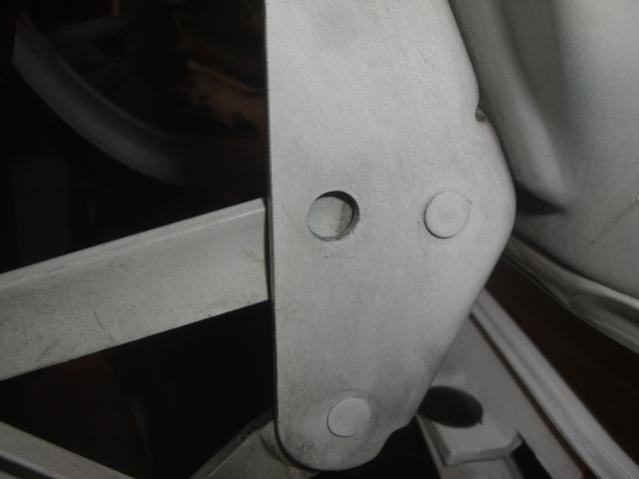

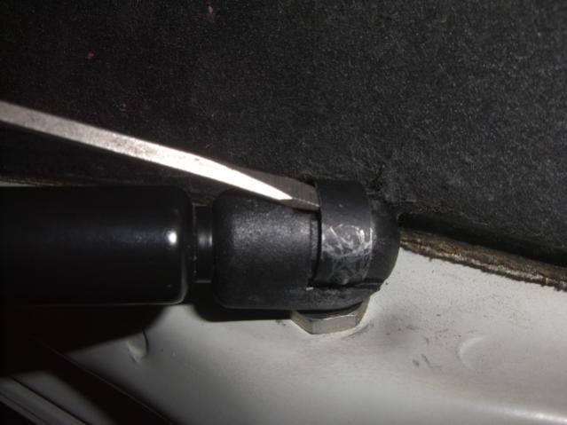

Remove the pneumatic lifts which support the hood, and raise the hood to 90 degrees vertical. On the each hinge, there is a hole through which a 3/8" bolt or screwdriver can be inserted to prevent the hood from moving off the perpendicular. At first this appears precarious, however, it is in fact quite stable.
To remove the lifts, first identify the ball and socket attachment points on the underside of the hood (and the engine bay). You will find a circular wide steel spring clip which holds ball into the socket cup. On either side of the clip, there is a small slot through which a narrow srewdriver may be inserted to pry up the clip. Take care to hold the clip, as they can fly off into 'outer space'. Once pulled loose from the ball the spring clip should be reattached to the socket assy.
I use a 4-5 foot length of wood pole, like a broom handle to support the hood after removing the first side and before going around the car to detach the second side.
The return the lift to its normal configuration, the socket assy maybe pressed back onto the ball by simply snapping it together.
Attached Thumbnails Noise scared me on start...vid w/sound included-hoodsupportclip-001.jpg   Noise scared me on start...vid w/sound included-hoodsupportclip-005.jpg
