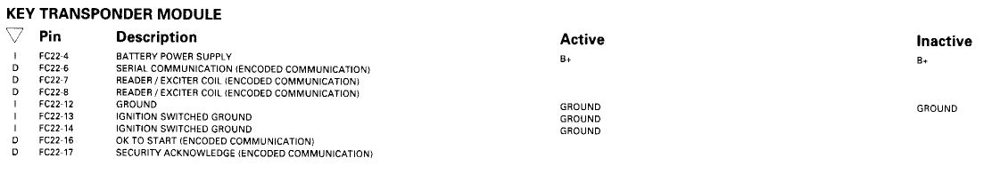

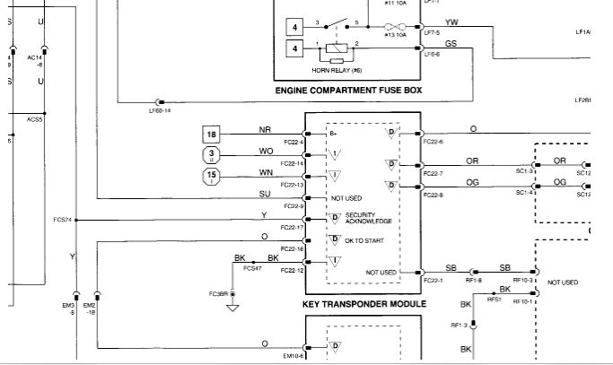

With the caveat that this is for a 98, I've attached the relevant snippets of the missing 13.2/3 diagram and the pinout list.
Pin 13 routes back through to the ignition switch position i (aux), and should ground when the key is in that position: see Fig. 2.1 in the 97 JTIS. Note that the relevant octagon connection symbol there contains 16 rather than the 15 shown on the snippet.
Double-check the wire colour on FC22 pin 13 - the 97 & 99 JTIS and the snippet all show a white/brown wire routing to that connection?

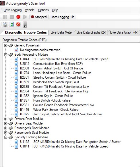

BPM is giving lots of (seemingly fake) error messages, attached above, for gadgets that are not problematic (like the wipers, seats, mirrors). But the BPM and the SLM are showing U1135 (invalid or missing data for ignition switch/starter).

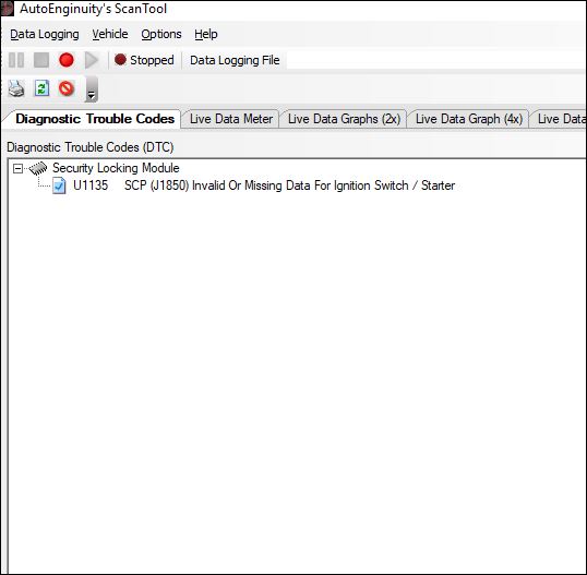

Your U1135 is directing me to the driver’s door and seat module to my knowledge they have nothing to do with starting the car. With no other codes I would clear it as suggested and do a hard reset and start from the beginning.

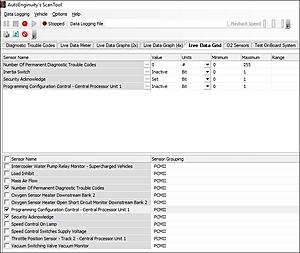

Attached are the current codes for the car and the diagram I am working off.

Just to recap on one thing I attached very early on - the car shows lots of errors coming from the BPM. I thought these were fake since the items listed are working perfectly.
Does the BPM have any effect on starting ?
Also, the U1041 and U2012 that the BPM is complaining about, would that be comms relating to instrument cluster ? Or should I expect to see some codes that actually mention instrument cluster, if the IC was problematic.

Imho there`s a problem with the BPM, a lot of failures:
Communication Bus Error!!!! (no communication with SLM and so Missing Data for Ignition Switch / Starter) , Ignition Key-In-Circuit Failure, so car couldn`t start.

I can see the errors for the BPM but I didn't think the BPM would prevent fuel/spark. According to the advanced electrical guide, the BPM would prevent cranking from happening - but that's not the case for my car, it cranks fine, it just doesn't get fuel/spark.
But I will pull the BPM out to take a look.
