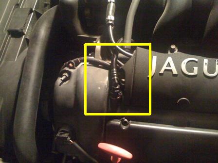

In the first picture ... is this the breather port that i need to make sure to clean? Is there a trick to removal or just straight up??

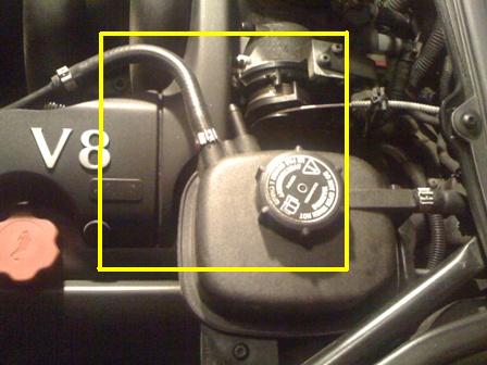

In the second... Looks like i should have something plugged in here or I could have a vac leak here???

Part Load breather . . . that's it!
Careful . . . the 10 year old plastic is a little brittle. I broke mine trying to clean the little orifice. Use a 'less that 1/8" 'drill bit to clean the orifice.
Makes a difference.
The other picture is of the coolant overflow reservoir. The 'capped' fitting is for when you break the primary one.

Okay.. now you have me worried... how does it remove... twist off?? or just pull up straight?

Yes. Twist and pull.

If you mean the little ring around the base of the breather next to the metal valve cover then yes.. it WAS brittle!! It just crumbled one side while i was twisting. Now... can i get a replacement at O'Rielly?? Or am i screwed? I still have not got the thing of either. I twist the top part but can not move the inner piece that is seated into that plastic ring.

Great! I got the tube off now... but lost a 1/8 of that plastic ring at the bottom. I stuck a tiny screwdriver in there and it is clogged. How deep to a clean that out?

Quarter inch or less. The thickness of the valve cover.

The reason that a drill bit is suggested is that the deposits are hard and not subject to pushing out of the way. Drill out the opening.
I used a piece of 'hobby' (ACE Hardware) thin wall brass tubing and some JB Weld to put mine back together.
The idea being that the interior pressure be directed through the tube to the throttle body.
