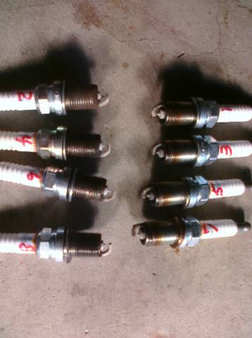

Update:
Just swapped out a new set of plugs today. All the right bank plugs showed varying accumulations of "junk"; worsening from front to rear. The 3 & 4 plugs (right bank) also did have a little oily gunk. But to be honest, neither the difference between the right and left banks, nor the amount of gunk on R3 & R4 seemed sufficient significant enough to account for the rate of oil consumption. See pics.
Just in case the oil burning was a transient state because to the MMO use, I'm starting a new record with the dip stick right up to the top line (but not over).
Out of curiosity: Has history identified some things that would cause just one bank of cylinders to burn differently? (and of course the solutions - lol)

Hard to see on those plug pics, but it looks like oil is getting into your plug wells on one side also. Valve cover leak perhaps?
