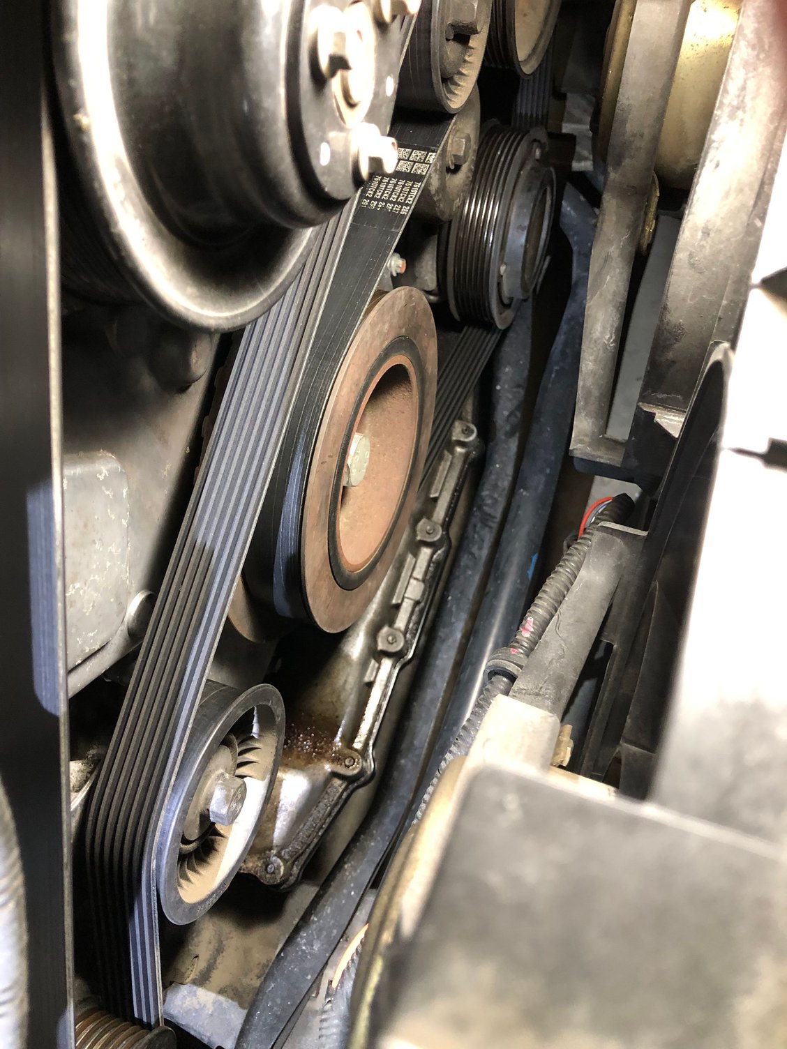

After tightening the oil pan bolts, thought problem solved. Today noticed 2 more drips on the garage floor. Visually from above, there is oil on the right hand side of the oil pan above the pan. Is it possible there is a pan seal leak and it is being blown up by air at speed or is there a potential leak above the pan? I cannot find a good diagram of the engine.

timing cover every single time

If I did this right, you can see where the oil is collecting on top of the oil pan on the right side of the engine. Probable source and how to fix. Someone said timing cover which was done 2 years ago. Any other probabilities. Has not had a leak in 25 years.
