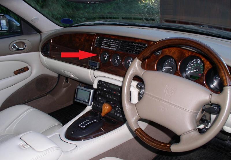

So it was the CENTRE Panel (arrowed in red), not the INSTRUMENT PACK bulbs you've changed?
Old Jan 9, 2013 | 02:38 PM
Bigvettefreak's Avatar
Joined: Oct 2011
Posts: 441
Likes: 28
From: Southern New Jersey
Attachment 29736
That is correct. That is why I am at a loss to understand this. It was one bulb. did not pull at wires nothing just removed and replace a bulb. frustrating.
