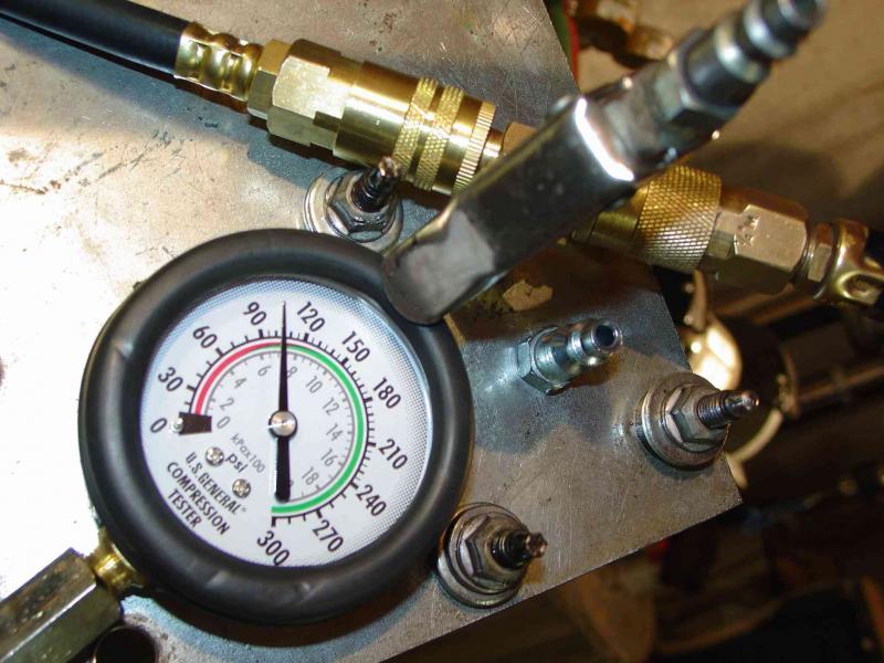

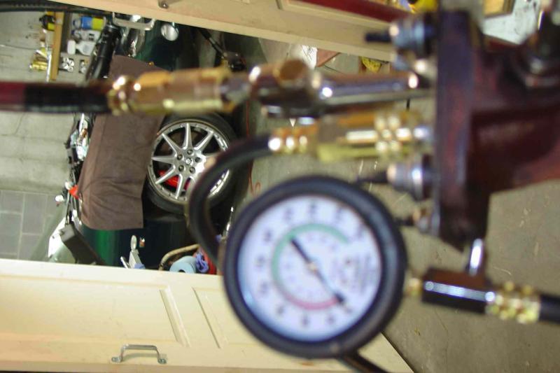

RE: Convertor... Although it LOOKED fine at first, I THOUGHT I was not getting enough air flow when I first ran air from my compressor through it - but I couldn't seal the air hose to the exhaust input well enough to satisfy my certainty. So I fabricated a flange for the input side that had both an air input nozzle and an air output nozzle - to hook to a pressure gage to see any back pressure that might develop. Well.... I noted ZERO back pressure at full column of air at 120psi from my "body-shop worthy" air supply. I'd say that convertor is flowing just fine.
Please see the attached pics below to see my silly home-brew convertor back pressure testing rig and also some fine shots of my equally contrived injector testor - The very one I used to establish that the professional cleaning and testing done by "Injector-RX" in Houston a month ago was spot on... Hey, look at the spray pattern at 45psi - NICE huh?
And NO I don't own "Chitty-Chitty-Bang-Bang," but my father WAS Caractacus Potts....
Thanks, again for the input ya-all... Now back to reassembly and the continued challenge of my lifetime.

Perhaps you could use an old spark plug and make a "test port" to replace the O2 sensors on either side, and then connect it to a fuel pressure gauge that reads up to, say, 5 psi. Then you could run the engine at idle, and then again at around 2000 rpm and note any difference in the exhaust backpressure without removing the cats or exhaust. If the pressure is the same, you need to look elsewhere. As I recall, up to 1.5 psi was considered pretty normal at 2000. Any more was considered problematic. I have no idea what the Jags are! I would also imagine that you can "buy" an O2 test fitting out there someplace!
Last edited by chopr; Aug 28, 2012 at 09:44 PM. Reason: The author already made up a test tool prior to my post!

Yeah, good idea "chopr" You made me think.... I was using a compression gauge and they are not real good at displaying really low pressure. A fuel gage would have been better - and your spark plug idea for a "test port" on a running engine is a good one. Thank you.
