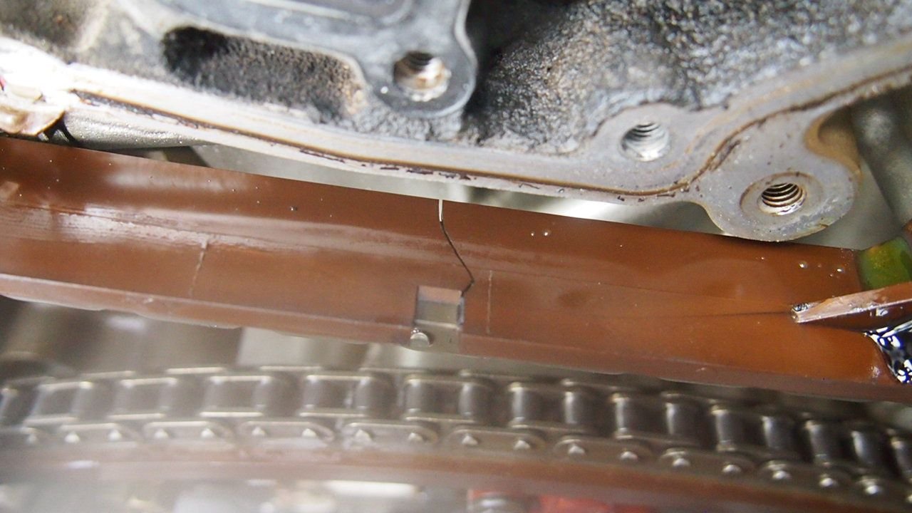

Hi, Soon as i put my foot on the accelerator the oil pressure went straight back up. i found out the problem today it was the primary timing chain tensioner.
Old Jun 26, 2016 | 08:29 PM
dan02xk8's Avatar
Posts: 39
From: louisiana

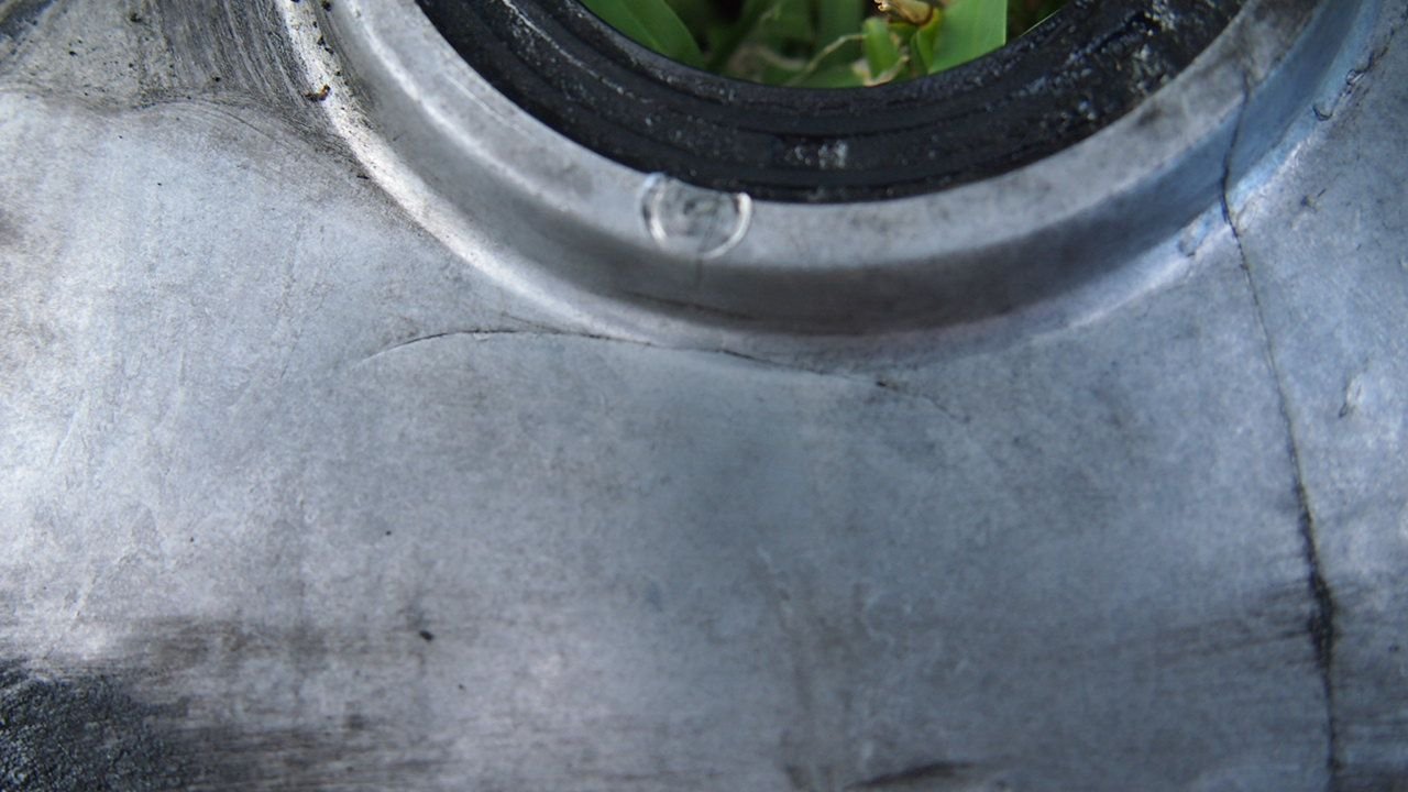

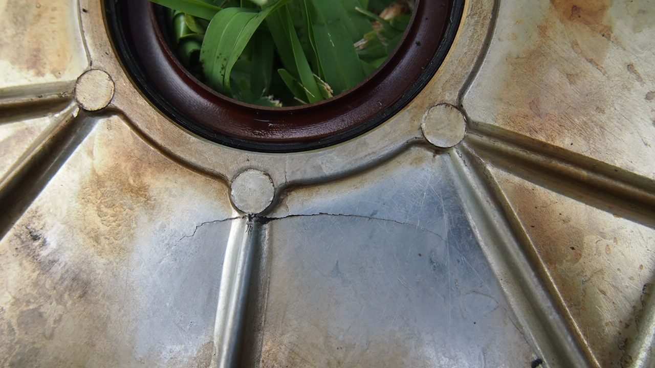

Cracked slipper guide and failure of the left (passenger side) primary timing chain tensioner
i cracked the timing chain cover can i remedy this with jb weld?
