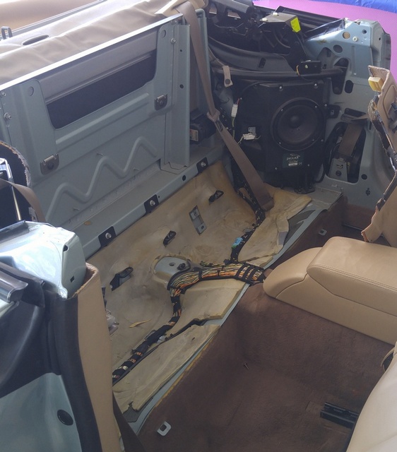

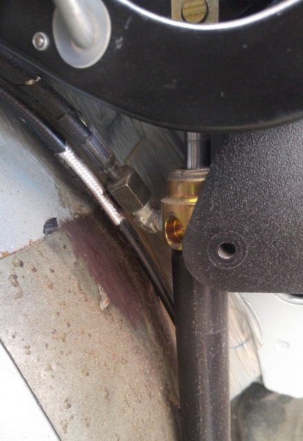

Repaired, finally! A visit to a local automobile interior shop helped identify the probable culprit; the hydraulic ram connector appeared to have detached from the bracket. The shop owner looked me right in the face and quoted me $450 for labor without blinking (minimum, plus any parts). Declining gracefully, I stopped on the way home to pick up a 6 pack. Following how-to's from other threads on this forum, I easily removed the back seat and the entire side panel covering the subwoofer, then removed the subwoofer housing itself. I had to remove the tubular cross brace to lift the subwoofer up and over the bolts in the floor. The issue was immediately obvious: the hydraulic cylinder had detached from the bracket. I thought at first that the bolt that secured the hydraulic cylinder to the frame had vibrated out, but I could not find it anywhere!
After 15 minutes of looking under everything and several more minutes of fruitless Google searches, I went back to the car, started beating on things, and learned the real answer. The reason I couldn't find the bolt is because.... there is none! I was going to re-position and secure the hydraulic cylinder in place with the end of a slender screwdriver until I get a replacement pin/bolt but, when I (slowly and gently) pried the cylinder back into position with a breaker bar, it literally popped securely back into place.
Seems that there is a protrusion in the bracket that fits neatly into the recess of the cylinder and it's very hard to see (especially when you're not looking for it). What looks like the signs of a (missing) bolt head on the side of the bracket is actually the back of the welded protrusion.

Redline, Glad you found your problem. Did the plate that holds that pivot have the 3 screws in it? Looks like one is missing and that may have been the cause of it popping out.

Thanks; good observation! The empty screw hole to the right of the hydraulic cylinder pivot point is the lowest of 3 plate fasteners, and it's also the point where the shirt-tail of the headliner attaches. (You have to get the headliner out of the way to see the top of the hydraulic cylinder). It was pretty easy to persuade the cylinder back into position with that screw out.
