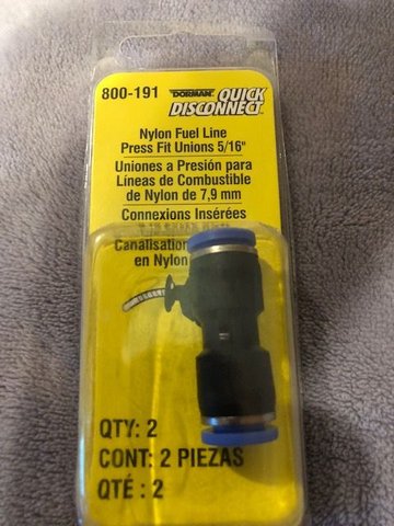

Hi Everyone,I would like to contribute to this well-known issue of XK8/XKR and the solution to fix it.
Forget about the heat shrink tubing method. Given the tension, I bet it will eventually come loose.
Instead, I found a Nyon Fuel Line Press Fit Union 5/16" from my local auto parts store. It works like a charm.
It has metal teeth inside to grab on the cable and it has plastic housing. Works perfectly.
I have one extra piece of the press fit union available if anyone is interested.
Total cable
removal is 20mm, that is 12mm + 8mm to account for the extra spacing from the Press Fit union.
