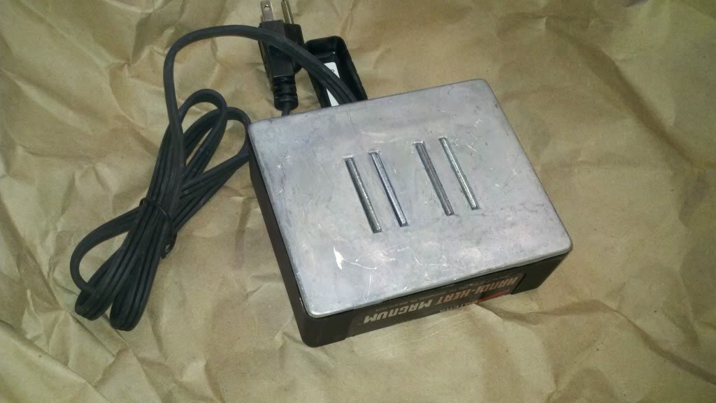

I bought this one used, but many types are easy to find on eBay and elsewhere. This one doesn't require adhesive due to the powerful magnets that are built in. The idea is to stick it on a steel area, like the oil pan cover, and have it on for about an hour prior to driving in the winter. That heats the engine's oil supply prior to driving, minimizing emissions and engine wear at start up.
If this technique works, it will be nice to have the XKR warmed up and ready for sporty driving prior to getting 1/2 way to work. I can route the power cord to come up and rest by the base of the driver's side windshield wiper for easy access/use. Powered by an electric cord in the garage that is controlled by an affordable plug-in timer, it should be low hassle (we'll see).
Has anyone else used a block heater for this purpose?

This oil heater works INCREDIBLY WELL.
For those that haven't read about it, I will be installing an AVos twin screw supercharger kit at some point between mid December and January, depending on when the kit arrives.
My engine has a knocking sound if I apply more than half throttle prior to the engine being warmed, which typically takes about 10 minutes of driving, or half way to my factory. That condition, and a minor oil leak from a reservoir that is behind the radiator, will be fixed immediately prior to the supercharger kit being installed. The engine runs strong and 'knock/sound free' after it has warmed.
Here's the scoop... I used the oil/block heater this morning for the first time. I turned it on about one hour prior to driving (turning on the power switch after waking). I unplugged the cord, then hopped in the XKR to drive my step-son to school. Knowing that this was a test to see if the oil heater worked, after driving only about one mile, with the temperature gauge still showing a cold condition, I hit the throttle. There were no sounds or knocks whatsoever and the engine screamed with lots of power due to the cold engine block. I then applied heavy short bursts of throttle a few more times while the engine was still cold. Not one single bad sound was heard (except for a spinning rear tire).
I will confirm that this remains to be beneficial, then switch to a permanent block heater during the supercharger install.
The plug-in for the heater is up by the base of the driver side windshield arm. Temperature this morning: 55 degrees F.

This is second day that I have driven, having used the block heater for one hour prior to driving.
This 'widget' is awesome!
The engine fires right up and runs smooth as silk from the instant that I turn on the engine... it is smooth as velvet.
The engine just seems happy to be running. It's hard to describe... the difference in the drive is instant, immediately after starting the engine. The car seems to say to you, "OK, already... let's go!"

The heater that I'm using is between the front wheels, so it's not TOO bad for a location. It has been clearing all of the speed bumps and drive entrances.
Now that I see the benefits of using the heater, I will be installing a permanent one in about 2 months when the supercharger is installed. That will relieve the vehicle of having that big block hanging there.
