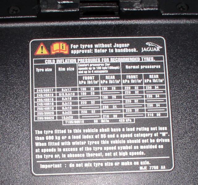

What kind of tire pressure do you run? Does it change with the time of year or weather? I looked at the chart under the arm rest (after I got it unjammed haha), and couldn't make any sense out of it.

Mark,
Impressed you've been able to read it - I had to take the lid off.
It's over complicated because it lists all wheel and tyre size options available for the vehicle instead of just the ones fitted.
Pressure! Pressure! Pressure!:d-05-tyre-pressures.jpg
Column 1 = Tyre Sizes
Column 2 = Wheel Sizes
Columns 3 & 4 = Comfort Pressures (up to 100 mph)
Columns 5 & 6 = Normal Pressures (for most of us)
Spacesaver Spare Wheel details in the bottom box by itself
Pressures in PSI are the figures on the right. KPa (Kilopascals for the scientifically minded) equivalents on the left.
I use 'normal' recommended settings so my fronts (255/35R20 on 8J x 20 Sepang) are 32 PSI and rears (285/30R20 on 10J x 20 Sepang) are 30 PSI. Pressures can rise by up to 2 psi from cold after a long run.
Winter / Summer doesn't make much difference - to tyre pressures or temperature here!

Old Feb 13, 2012 | 05:31 PM
Mark,
The settings given on the label under the armrest are 'cold inflation pressures for recommended tyres. For tyres without Jaguar approval, refer to the handbook.'
The handbook includes the further advice that tyres without Jaguar approval 'should be inflated to 14KPa / 2 PSI higher than the pressures listed on the label for the appropriate size'
The recommended pressures are supposed to be those which will give the best compromise between comfort and durability.
The factors influencing appropriate pressure are [rim size] + [tyre size] + [tyre make / speed rating] which is going to give quite a broad range. Test point has extended this to include [local road conditions] to determine his optimum pressures.
