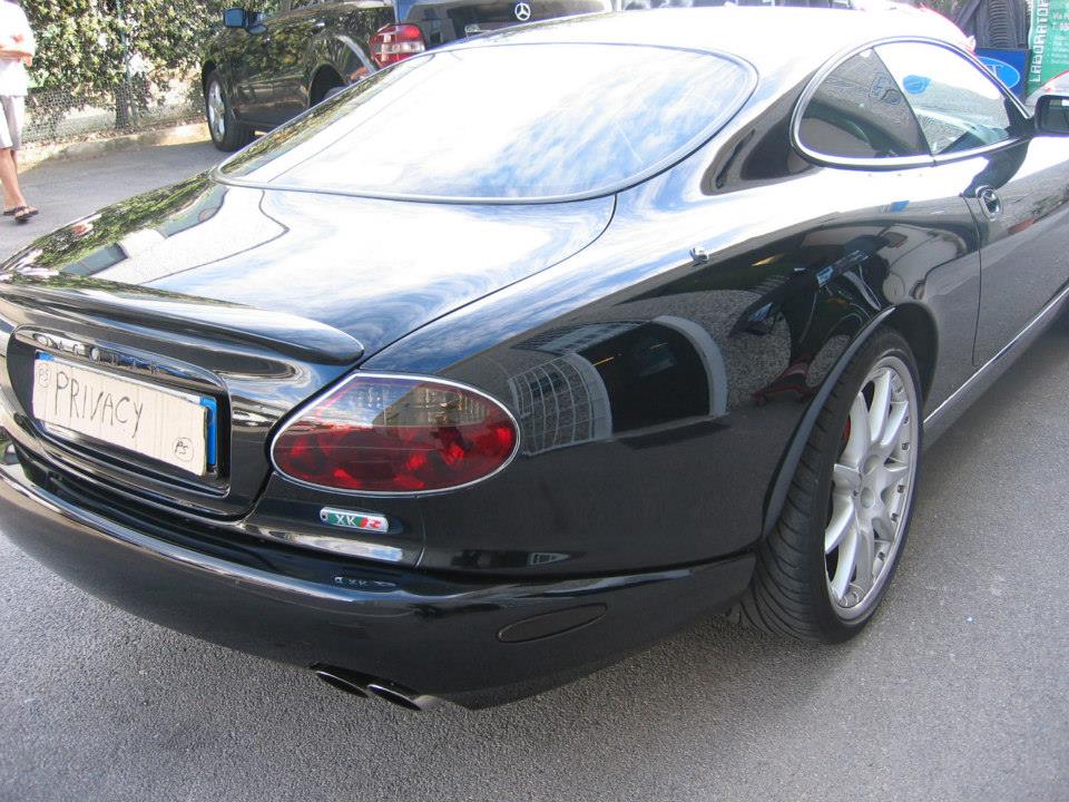

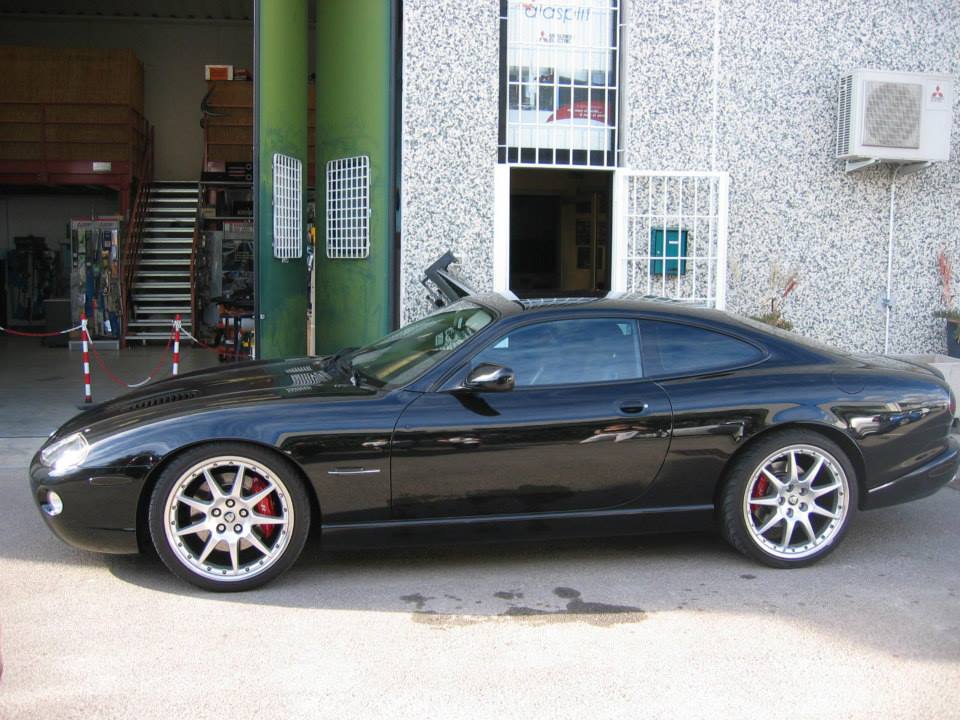

I just installed obscured film (Llumar) on the rear window and rear side windows of my coupe and it is now more difficult than opening the doors by remote control. I told the foreman of Jaguar workshop that this depends on the film applied to the rear window where there is antenna for opening doors.
Possible?

The antenna on the rear window is on the inner surface of the glass so having a film applied on the inside shouldn't interfere with the signal from the fob outside the vehicle.
I was looking for a photo of the rear window of my 2005 XK8 but don't have one which shows the antenna. If I recall correctly, the lead from the antenna goes onto a press stud on the headliner. Is this lead damaged or not been refitted correctly after the film was applied?

I just saw on top of the rear window electrical connection of the antenna. Today we're going to check if there are any rust or other problems on electric contact, then I'll let you know.
I also thought it was exhausted battery in the remote but when i have replaced it the problem has remained the same

We found the problem.
In the Llumar darkness films are present metal particles in the composition, and this creates a problem with the reception antenna of the rear window.
