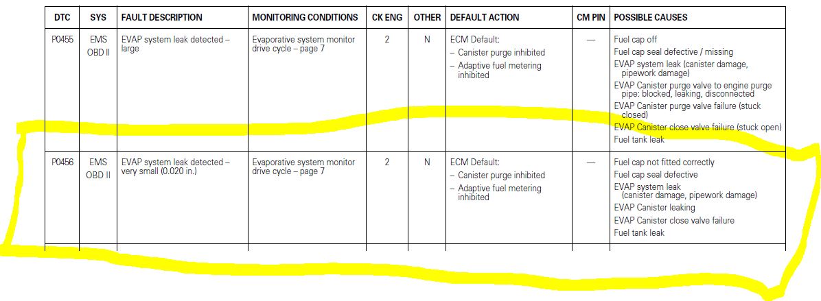

I should have looked up the code earlier. According to JTIS, it probably is not a purge valve issue, so the noise could be the system inhibiting the purge valve to compensate for another problem.
The small evap. leak is not something that should prevent you from driving the car until it is repaired. It will likely prevent you from passing a state emissions inspection however.
A new fuel cap would be an inexpensive, logical place to start.
Attached Thumbnails Purge Valve Ticking - What makes it tick?-capture-p0456.jpg

I guess maybe I was looking too hard for a bigger problem.
I checked the gas cap and it was tight but the seal was a little wet with fuel. There was some buildup on the filler tube inlet face so I cleaned that up and cleaned the cap.
Cleared the code and so far it has not returned after a 30 minute drive.
