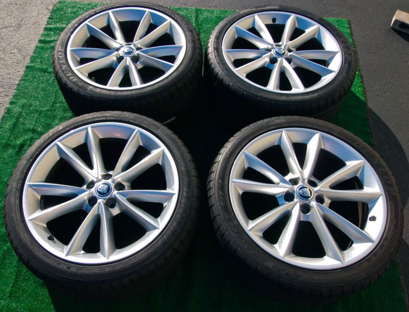

Speaking or wheels - I'm prone to the 19" Tamana's - which run circles around the Revolvers and totally change the look.
I've also ordered a front air dam and XK150 rear spoiler/brake light - together with the R hood I picked up - basically a straight up trade for my stock hood - I think my 8 will look pretty sweet...

Revolvers are such a horrible wheel for these cars (although interestingly enough they look quite nice on XJ8s). Those wheels look quite nice. I'm one of the younger ones, just under 30 for a couple of months and I bought my XK8 just before I hit 25. My wife sometimes accuses me of old man taste but I just tell her I am refined.

Yes wheels definitely make or break the XK's; it's amazing how the right wheels can not only change the appearance but also the aggressiveness of the car. I know they had to differentiate between the 8 and the R - but damn the R is simply awesome - that's why if I can't have an R (for now, anyway) I want to make my 8 look as good as I can to appease my own taste and vision that I have for it. When I was your age I was playing with Mustangs - both old and new. If the XK's were around back then I don't know if I would've wanted one or not. The XJ was around back then and it definitely was thought of as an old fogie car. I just like the fact that the XK's are such a bitchin' car, you don't see them on the road every day, they're very inexpensive to buy (especially compared to how much they were new) and they turn heads. Yes, we may beat to the drum of a different drummer, but I like to think our drummer is John Bonham and the rest of the world beats to the drum of Peter Chris...
