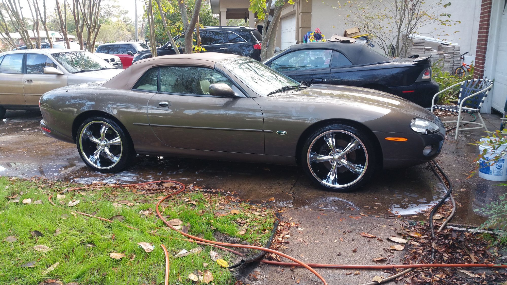

Hello everyone. I have completed the front end suspension overhaul on the jag. Wow does she ride great now. I can now feel the rear suspension more than the front and want to see if there is a specific set of shocks I should get. I put the bilstein b3 shocks in the front with the poly urethane shock mounts. Should I go ahead and order the same ones for the rear? Just want to get a general consensus because I first changed the mounts out with the parts geek shock mounts and I read that they fail pretty quickly which is why when I changed the shocks I got the poly urethane mounts. Finally got a good picture of the car after i detailed it rigorously.

Thank you for the replies! I guess I will go for the same bilsteins for the rear. They are great shocks. I really like the way the car handles now. I am working out these issues here and there with the car. Every month I get something else corrected and enjoy the car more and more. The jag sure does turns heads after its been detailed!
