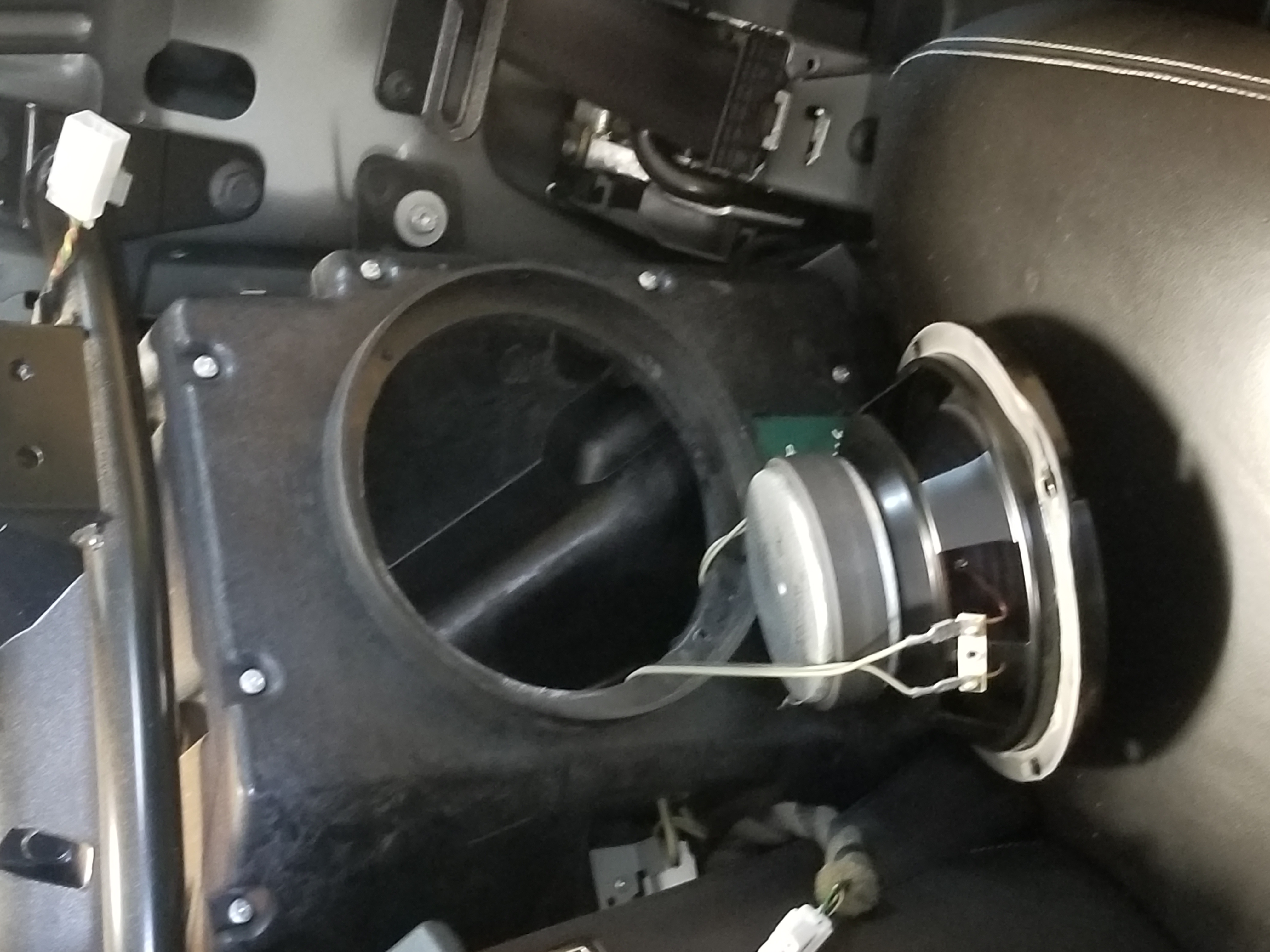

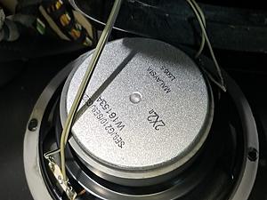

So I ended up on this thread because I thought I needed a new rear speaker for my 2006 XKR Vert. Once I took things apart I found that the connector was just hanging loose. Once connected, the speaker seems to work fine. However, I wanted to add some info on what I found to this illustrious body of knowledge.
There is only one speaker and it has dual 2 ohm voice coils. (pictures below) I have an older 2002-2003 electrical schematic and from the color of the wires I deduce that the wires running to it that are for the rear sub and for the rear mid-range (my schematic says only for the coupe) as well. I've only looked at the left side but expect I'll find corresponding wiring on the rt.
Since I have it apart I'm thinking I might as well upgrade the speakers so I'm looking for suggestions for an upgrade. I am looking at the sub speakers mentioned here. Will they handle the mid range as well?
