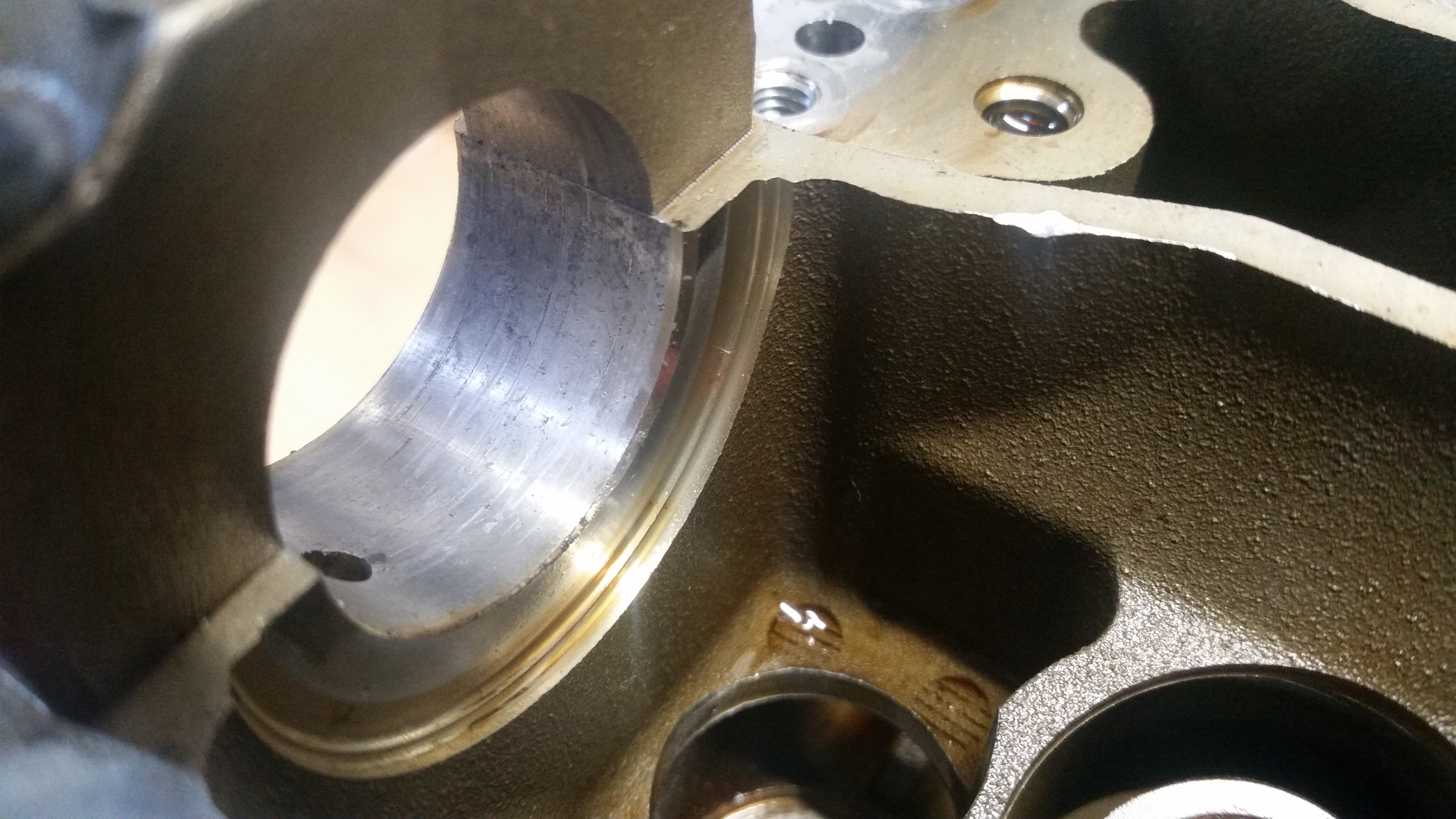

You can see the scratches in the journals and on one of the cam buckets.

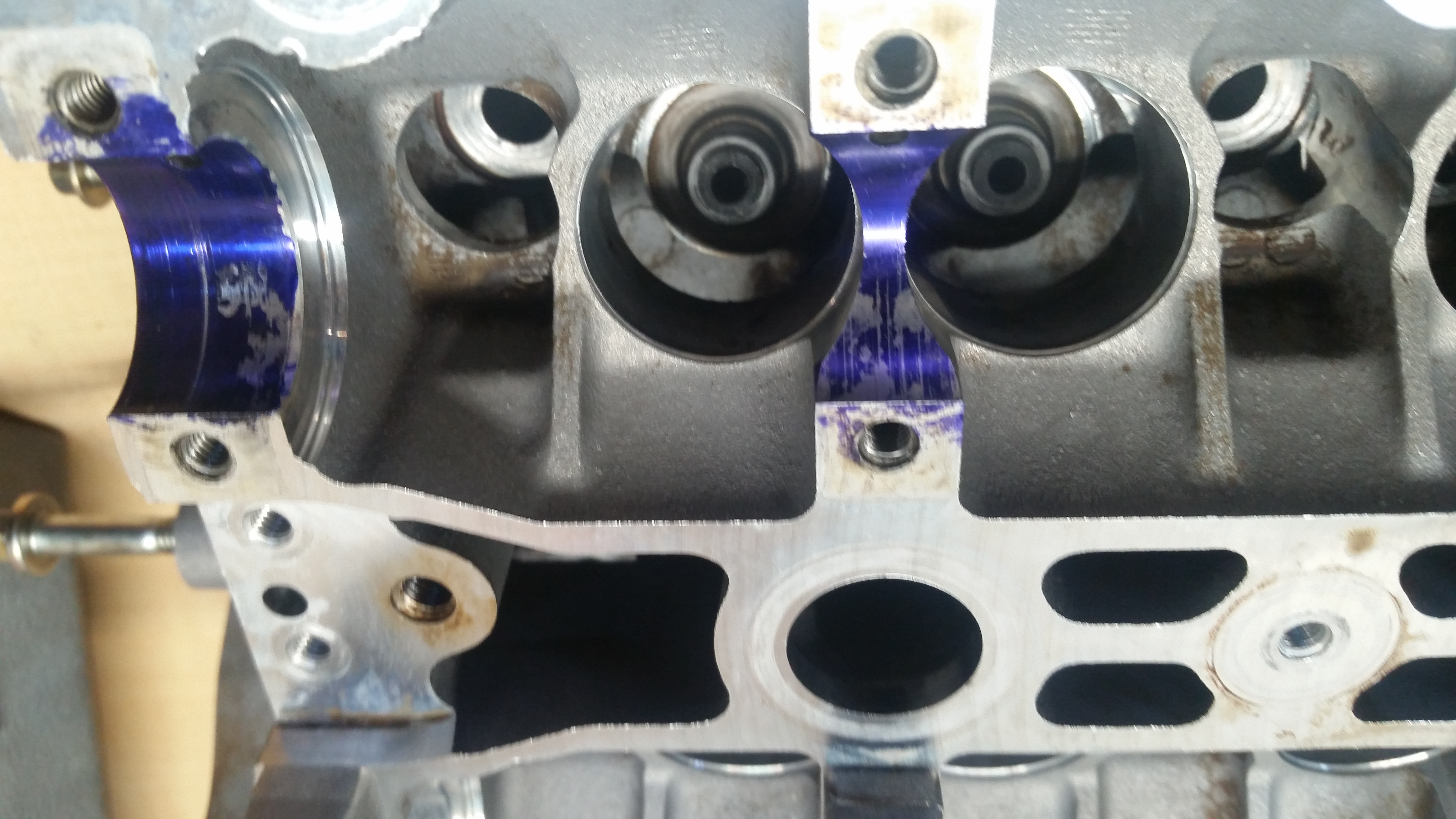

Now I put steel blue layout fluid on the cam journals and caps.
https://www.jaguarforums.com/forum/a...1&d=1477758988
Next I reinstall the cams, torque them to proper torque, and turn them several times. Then remove the cams to see how the cams are working in the journals.
https://www.jaguarforums.com/forum/a...1&d=1477759711

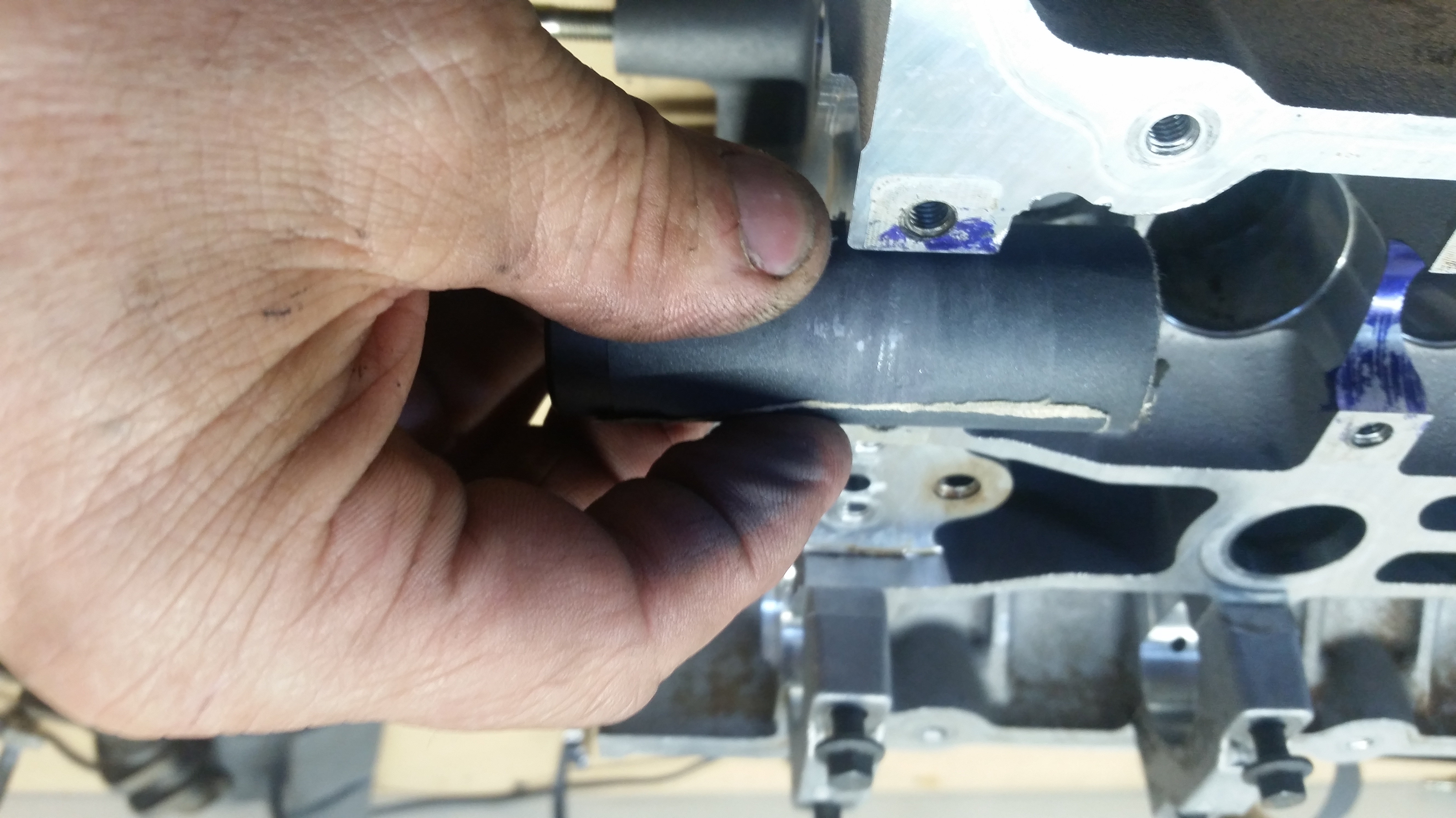

In the photo you can see that the cam is riding where the blue is gone. Get a socket that is as close to the size of the journal but not bigger than the journal. Then wrap a piece of 1200 wet and dry around the socket and sand the journals and caps to remove the scratches and cut down the high spots where the blue is gone. You need to do a little at a time and add more blue when needed to check progress.

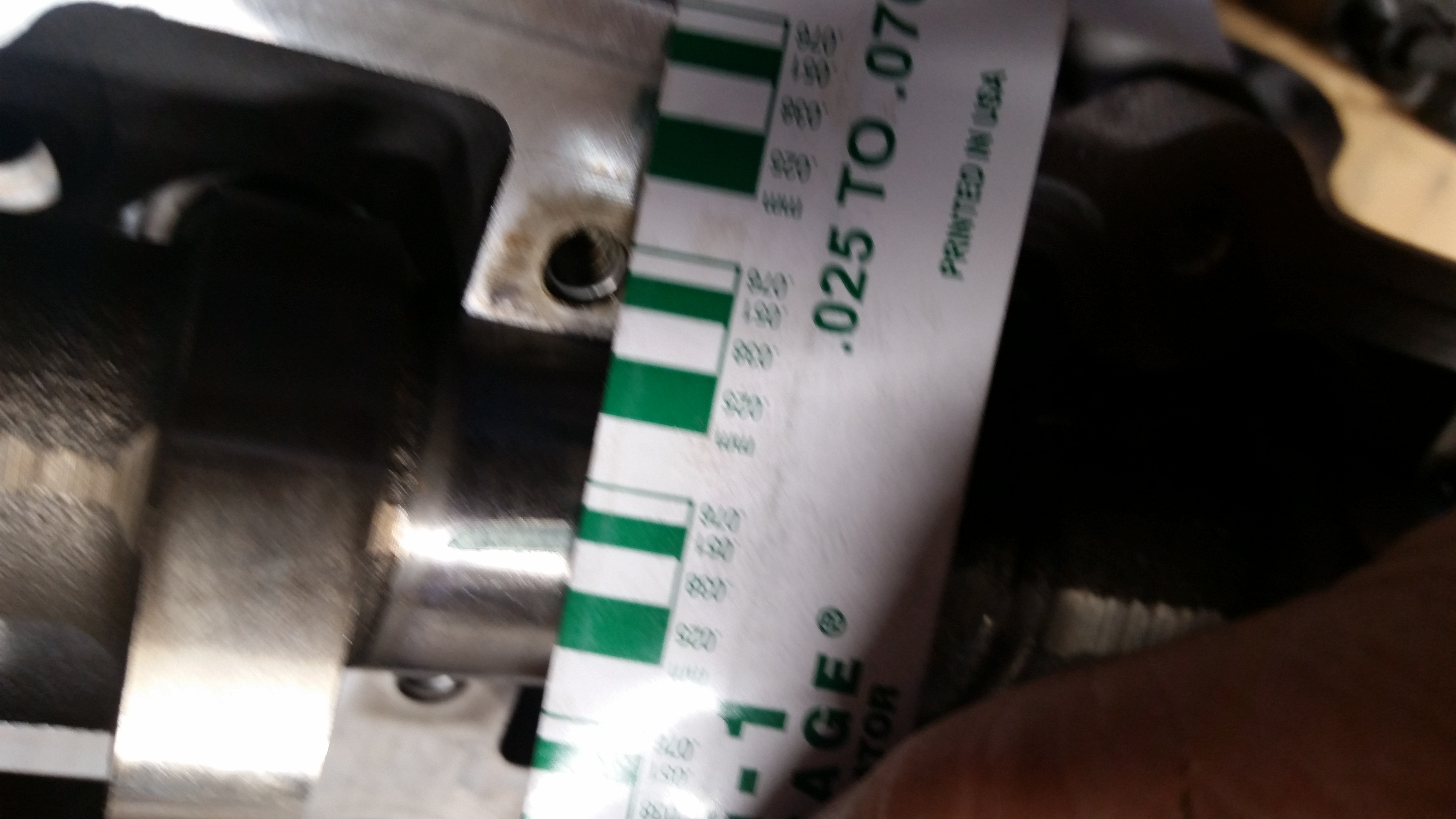

Now to get the clearances correct you wI'll need to get what they call plastigague. I got mine from Autozone but I think most parts stores should have it. What it is is thin string of soft plastic that you put between two surfaces then as you bring the two surfaces together it flattens out then you use a gague that comes with the plastigague to see what the clearance is.
Take the cam and put it back in the head. Put a piece of plastigague on each journal. Install the cam caps and torque to specs, 9-11Nm. After all caps have been torqued remove them and use the gague to check clearances from the now compress plastigague. I can't remember the exact clearances but from memory I tried to get it between .040 to .060mm. In the photo the gague shows it closer to .076mm.
https://www.jaguarforums.com/forum/a...1&d=1477800410

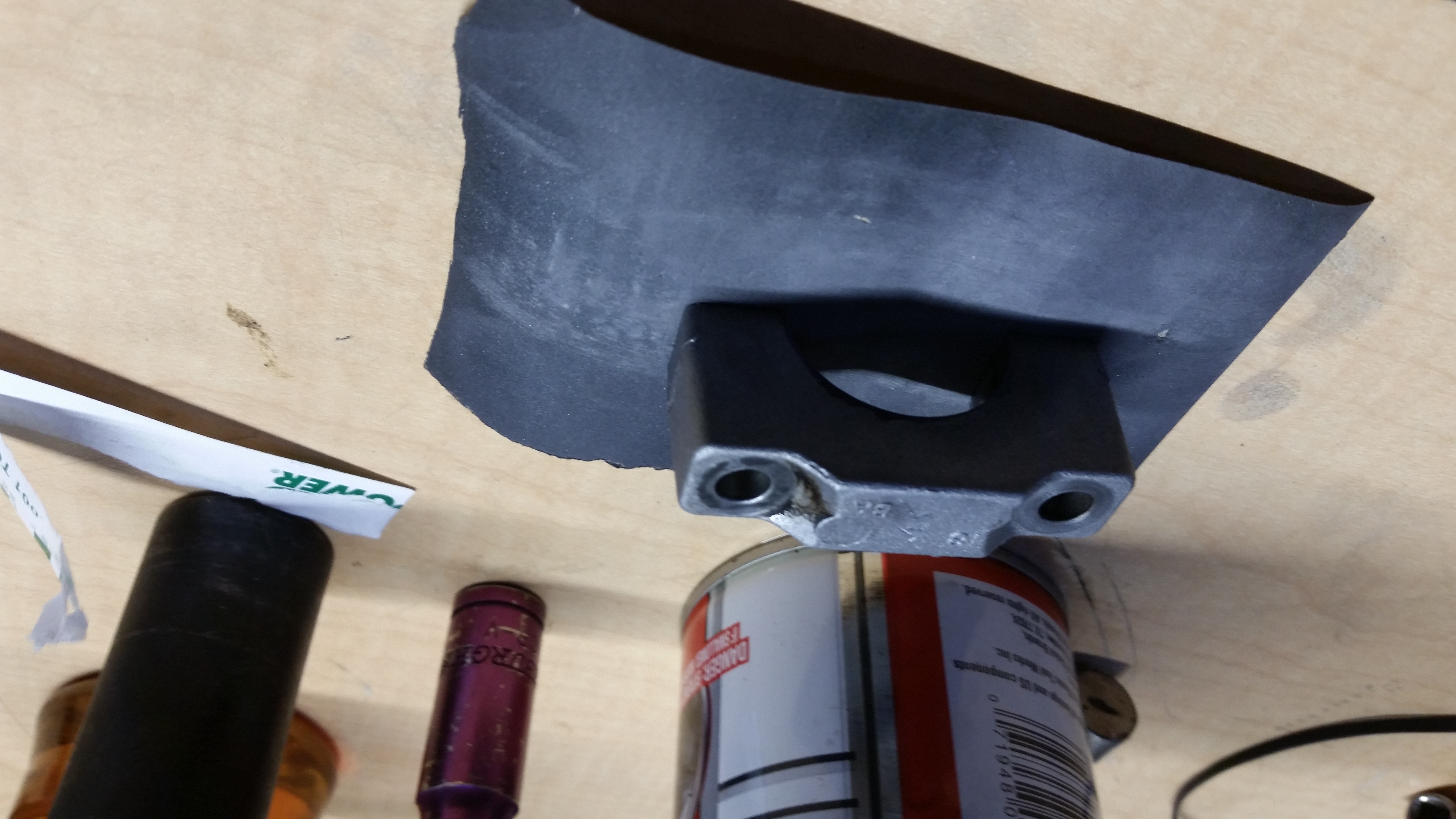

Too much clearance. Take the cam cap for that journal and run it across a piece of 1200 wet and dry on a flat surface.
https://www.jaguarforums.com/forum/a...1&d=1477802076

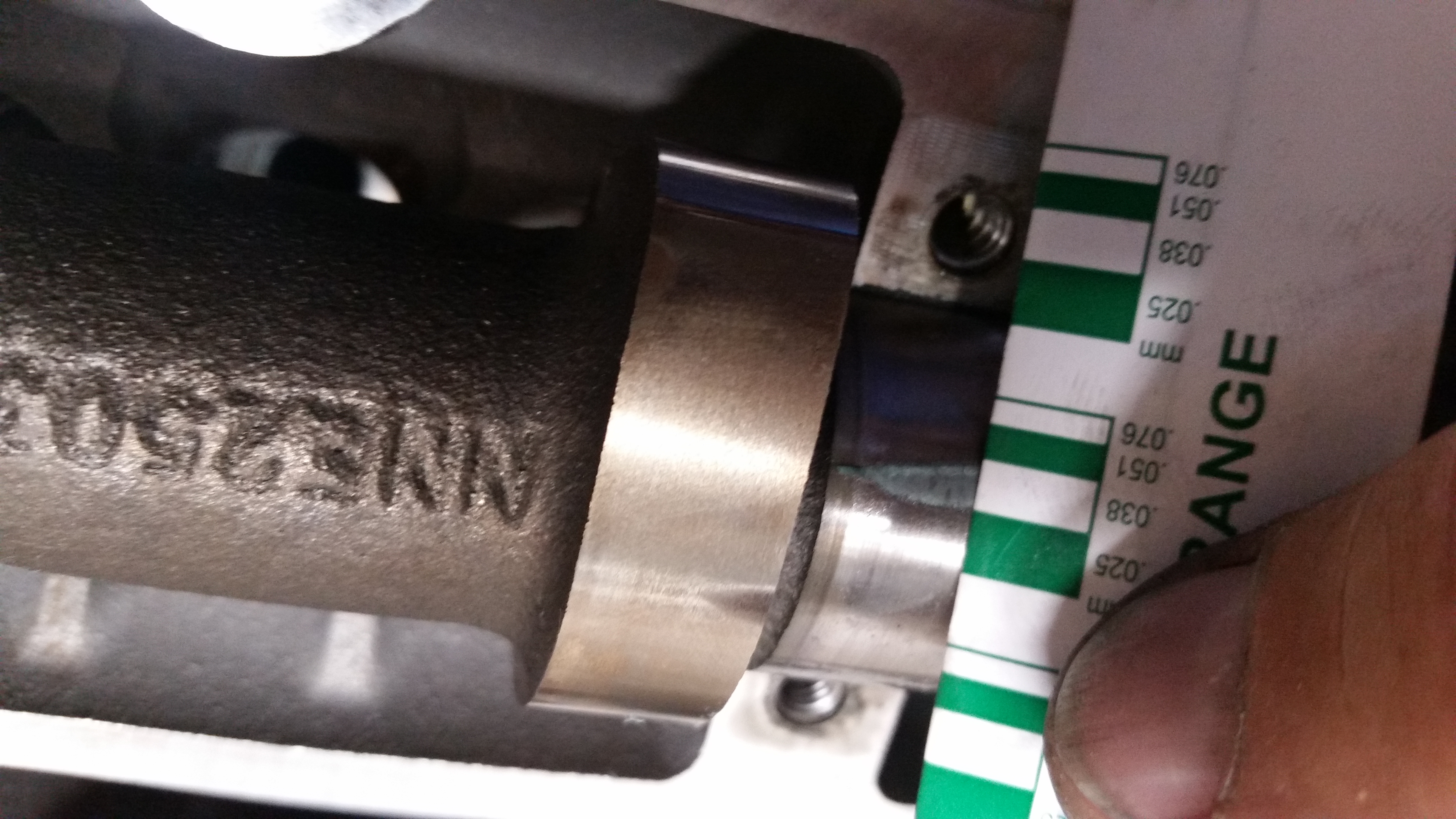

Take a new piece of plastigague and recheck clearance. I now getting between .038 and .051mm. I guessing about .045mm. The clearance is now correct.
https://www.jaguarforums.com/forum/a...1&d=1477800946
