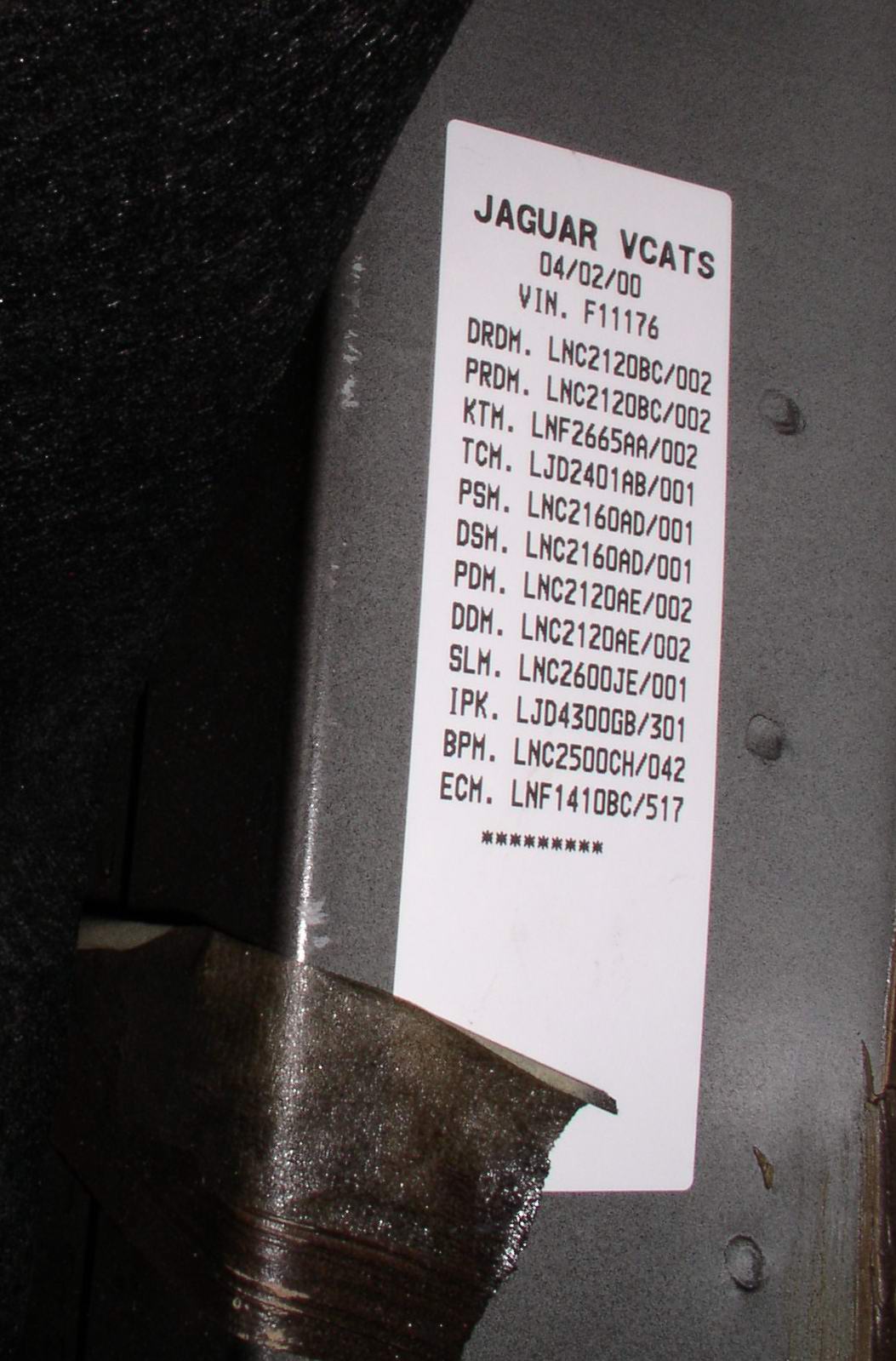

I have a 03 XK8 flood car & the principally the trunk got soaked. Headlamps & dash, light up. I needed to purchase(& did) the security & locking module, but the car didn't come with keyless remote. If I purchase a Jag remote will I be able to program it?
Old Jun 24, 2013 | 03:59 AM
Provided you obtain a remote of the correct frequency (US and Europe are different) and correct series number for your model year, you will be able to program it yourself.
However, it may not be that straightforward as the SLM (Security & Locking Control Module) is a programmable module and is not necessarily interchangeable from one vehicle to another without reprogramming. Module programming requires dealer level diagnostic equipment.
I'll be interested to see other members replies to this as I have no experience in replacing SLM's.
Did you check the VCATS (Vehicle Configuration & Test System) label on the luggage compartment floor for the identity of the SLM fitted to your vehicle and obtain one with the same identity number?
This VCATS label pic is from my last X308 but the XK8/XKR is the same type of label.

I'll have to check re: the VCATS.Since it was the trunk that got soaked the sticker may be either missing or toast!
Any idea ballpark what the cost to have a dealer reprogram it would be?
