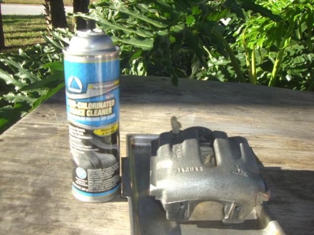

Default Used G2 epoxy coating on brake calipers for $35
Regular spray paint, even caliper paint, is too thin to provide a smooth coating on the rough surface of the caliper. Plus it is susceptible to brake fluid and other solvents.
Powder coating is thicker, but because it cures at 400'F. it requires too much prep work. It is also more expensive than other methods
I used the G2 epoxy coating on both the calipers and the rotor hats.
Attached Thumbnails Red Brake Calipers-brakes-026.jpg   Red Brake Calipers-brakes-033.jpg   Red Brake Calipers-brakes-055.jpg   Red Brake Calipers-brakes-067.jpg

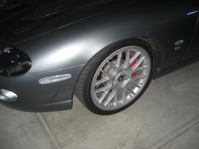

Originally Posted by DaleD
...What are we doing to this beautiful design guys? I'm trying to keep mine as close to factory as possible, and others are talking about all the cosmetic alterations they can do and and make - and which are "good" and which aren't...
I have factory red calipers and aftermarket clear side marker lights (front only). I truly believe the platinum/quartz XKs benefit from the removal of the amber lenses which do not relate to anything else on the car see pic #2. I do not think tasteful mods to enhance the design do not detract from the car at all. Then again, taste is a matter of personal preference, so to each his own.
By the way lowering also helps clean up the design; the factory wheel clearance is an abomination and the one thing that is totally wrong about these cars. I do not know if i believe this but rumor has it Ford dictated the clearance so snow chains could be added to the original 17" Revolver wheels.
