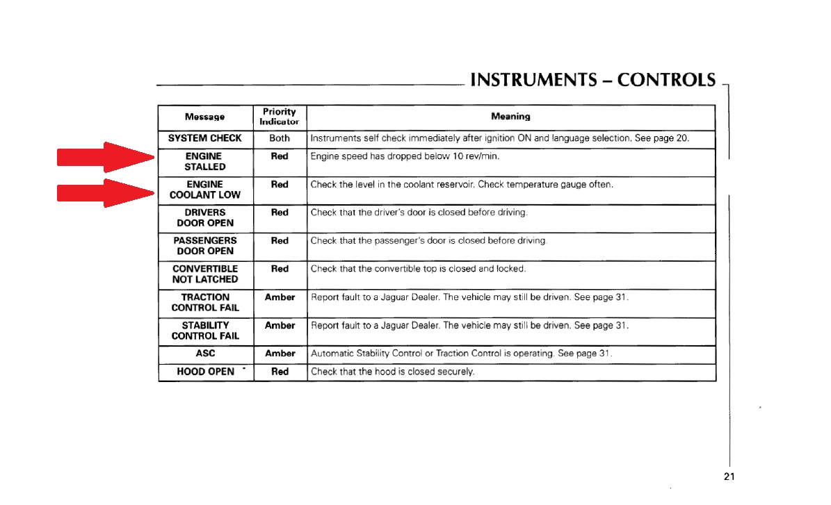

Did you get a chance to read the message clearly?
The only two RED warnings in the message centre with ENGINE displayed for a '96 are:
A spurious out-of-range signal from the notoriously unreliable coolant level sensor is a good bet for the cause.

Thank you all for some excellent direction...today, I will try to systematically go through the various areas of the car that were recommended.
I was thinking, that when the warning light came on I was so surprised and alarmed that I didn't read it carefully, I only remember seeing the amber "Engine" script, it might have read "Engine Coolant" for all I know, it was on for just a few seconds and I was half-panicked.

Ok, I went through all the systems, connections, fluid levels, etc. as recommended. I had checked the coolant level a couple of times and it looked all right to me, but I guess I was wrong. Anyway, when i looked at it again, I had to put about 5 ounces of distilled water into the fill tank. I then went for a 20 mile ride. It was the only thing I could find...car ran great, no warning lights. Thanks everybody

IMHO, heed well the post from Graham [GGG].
There are numerous threads on the "Low Level Coolant" issue and most intermittent faults appear to hinge on the sensor in the reservoir. Some have reported ongoing success from delving into reservoir with swabstick to clean the sensor tip. Given relatively low cost, most opt to replace with new sensor.
